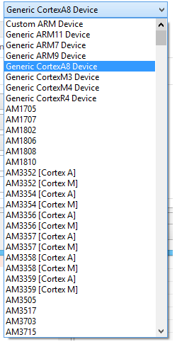

  • Hi Titus. I have Code Composer Studio Version: 5.5.0.00077
    The ARM options are shown below. Generic CortexA8 Device is available. But Generic CortexA15 Device isn't available.

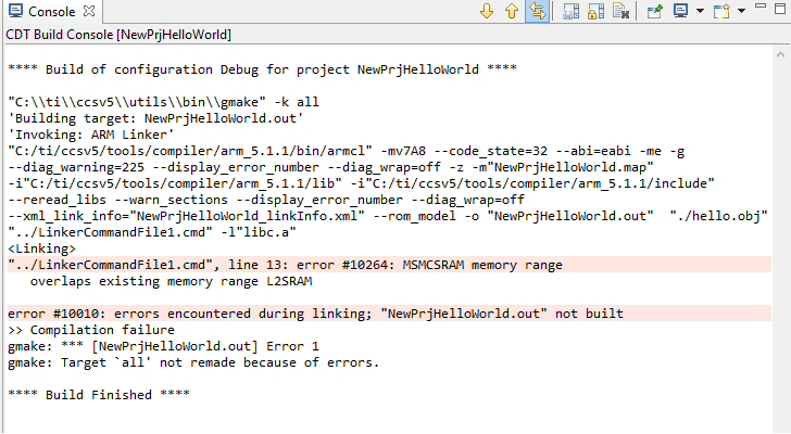

    I tried building for Generic CortexA8 Device with the linker command file from e2e.ti.com/.../430233
    But I get errors shown below.
    Can the 9 steps given by you in e2e.ti.com/.../430233 be adjusted for Code Composer Studio Version: 5.5.0.00077 ?  If so, please give the adjusted steps.

  • Hi Siddhartha,
    K2X devices has ARM cortex A15 cores not cortex A8 like AM335x devices.
    You need CCSv6.x (latest is CCSv6.1) version to create ARM cortex A15 projects.

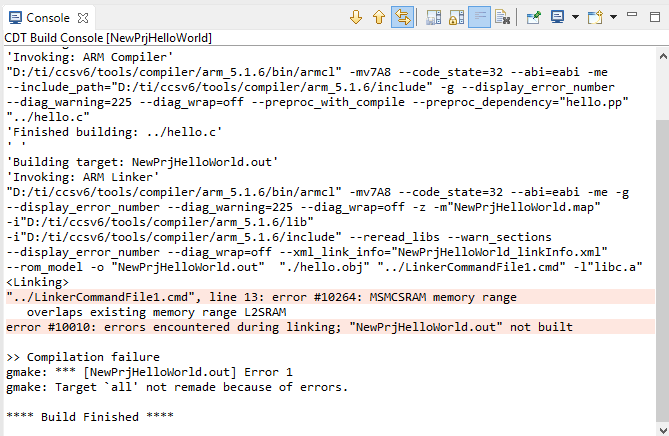

  • Hi Titus. I installed Code Composer Studio 6 (Version: 6.0.1.00040)
    For the hello world project mentioned in e2e.ti.com/.../430233
    I have these settings: Generic CortexA15 Device, Compiler TI v5.1.6, Linker command file is the one you gave in the above link
    When building - I get the error shown below
    My hello.c file has the code below

  • Hi Titus. My linker command file is attached below - it is identical to the code from your previous post.
    (Don't worry about the txt extension - this website doesn't allow cmd files to be attached, so I renamed the extension to cmd.txt)

    The error msg refers to overlap of MSMCSRAM (RWX) : org = 0xc000000, len = 0x600000 with L2SRAM: o = 0x0C000000 l = 0x00400000
    Can you suggest a different org value for MSMCSRAM ? Currently it looks identical to L2SRAM. (both are c000000)
    Siddhartha
  • Hi Siddhartha,
    Here I have modified the linker command file as per K2H memory map.

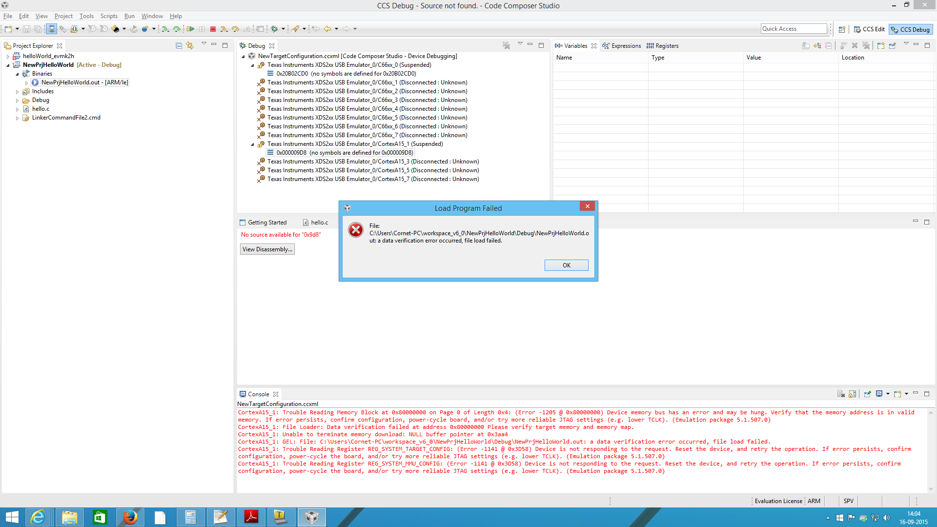

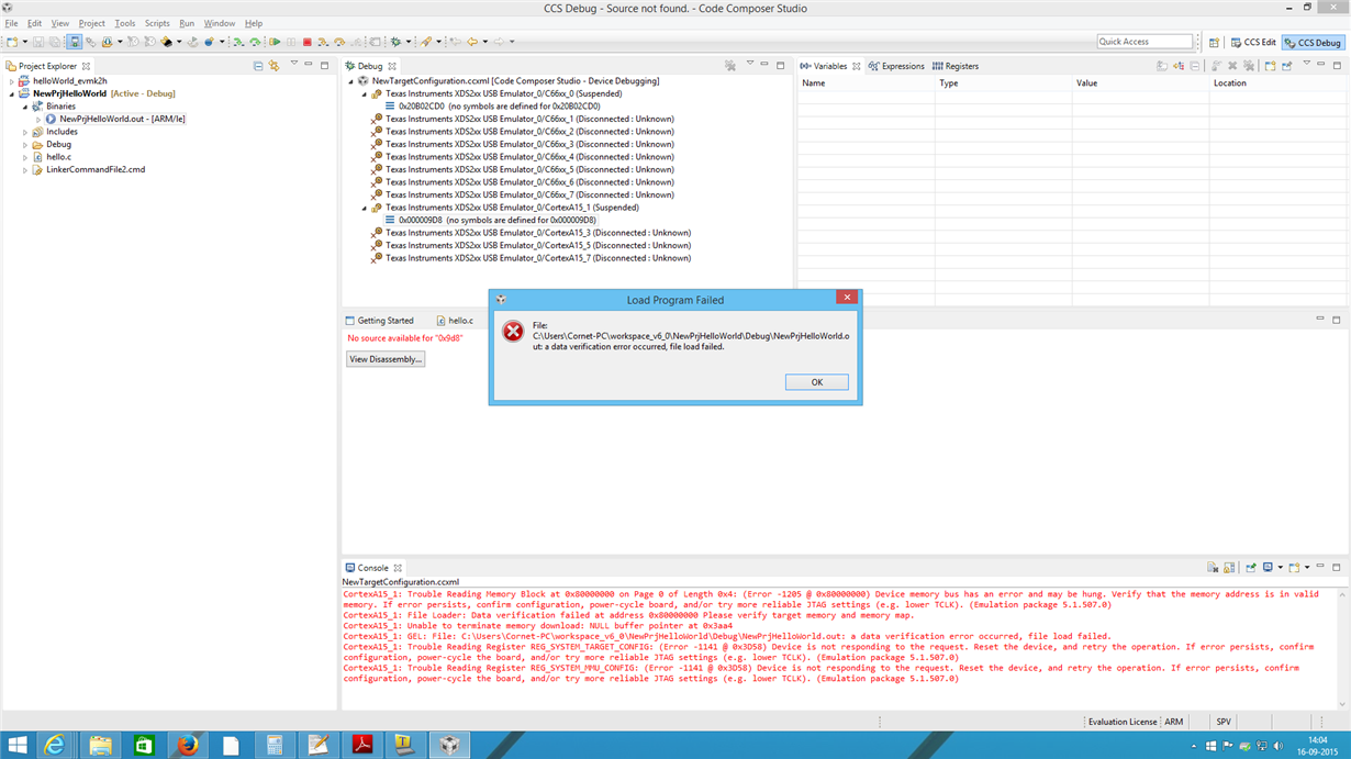

  • Hi Titus. Using your new linker command file - I was able to build a .out file without errors.
    When I load the .out file on the ARM core, I see the error below (see screenshot).
    If you need more info, please let me know.
    Siddhartha
    I can run the code.
    Did you connect DSP core0 first then connecting ARM core 0 ?
    Because DSP core 0 will call the gel file to initialize the DDR to run the code.
    Please make sure that you have selected/using the following target configuration.
    C:\ti\mcsdk_bios_3_01_03_06\tools\program_evm\configs\evmk2h\evmk2h.ccxml
  • Hi Titus. Ok I can set configuration to drive:\ti\mcsdk_bios_a_bb_cc_dd\tools\program_evm\configs\evmk2h\evmk2h.ccxml
    & see what happens. Where is the correct gel file for this configuration ?
    Siddhartha
  • Here you go.
    C:\ti\mcsdk_bios_3_01_03_06\tools\program_evm\gel\xtcievmk2x.gel
  • Thanks Titus. Using those settings I'm able to run the Hello World program on the Generic CortexA15 Device.
