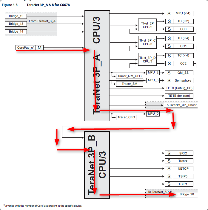

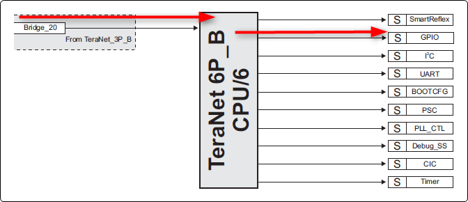

  • I think some clarification is needed regarding the data sheet specs.  These specs describe the GPIO peripheral and its associated I/O cell.  These do NOT comprehend system level considerations such as the impact of the interconnect.  The path from the CPU to the GPIO peripheral is found in the data manual.  Here's a quick mark-up:
    So as you can see, we are going through multiple bridges to get from the CorePac to the GPIO peripheral.  And there is sharing among other peripherals as well, e.g. if a different CorePac is trying to access UART or I2C on that same bridge, then there will be arbitration happening within the interconnect.  Finally, keep in mind that a read is fundamentally much different than a write.  Writes can be "fire and forget" where the CPU continues on while the write propagates to the peripheral.  A read requires the CPU to stall until the data comes back, and further more the path length effectively doubles since the data request has to go all the way to the peripheral, and then the data comes all the way back.
    So I think the results you're seeing are likely the expected results.  Now that said, there might be some optimizations to be made.
