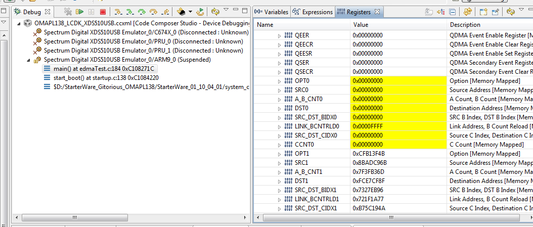

Hi all
I have found that Code Composer Studio view "Registers" shows 0 for all EDMA3 registers. I have tried to check Memory Browser and on range 0x01C00000u - 0x01C00200u there are all zeros too. McASP and I2C register values seems well in both memory browser and register views. Does it mean I am writing EDMA registers wrong way or it is a bug in CCS?
CCS version 5.5.0.00077
DSP 6747.
Thanks and regards.

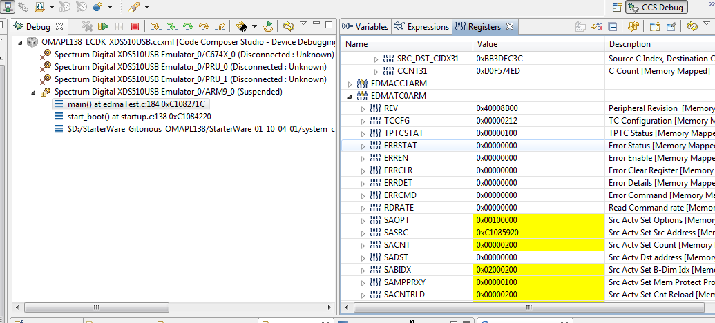

  • Hi Sergey,
    I have a OMAPL138 LCDK board which has the C6748 DSP core ( and not exactly the C6747 ) in it.
    Tried to run the following EDMA3 example and observed that the register values get changed on CCSv5.5 register window.
    C:\ti\OMAPL138_StarterWare_1_10_04_01\build\armv5\cgt_ccs\omapl138\lcdkOMAPL138\edma
    Which example are you using ?
  • Hi Shankari G!
    Unfortunately its not easy to describe which example I am using. Let me explain.
    According to 6747 datasheet, my EDMA3 registers is mapped to 0x01C0 0000. Thats why I have tried such things:
    volatile CSL_Edma3ccRegs* edma_regs = (CSL_Edma3ccRegs*) (0x01c00000);
    volatile Uint32 cfg = edma_regs->CCCFG;
    System_printf("CCCFG value : %lx\n", cfg);
    The result is like that:
    CCCFG value : c0004ad0
    But looking at the Table 16-22, 6747 TechRefManual - it doesn't seems possible value for EDMA3 CCCFG. Furthermore, memory browser and registers view still shows zeroes.
    I wonder if you give me some ideas what to try next.
    Thank you.
  • Hi all!
    I just forgot to enable EDMA3 via PSC :) Now it works well; so, I am revoking the question.
