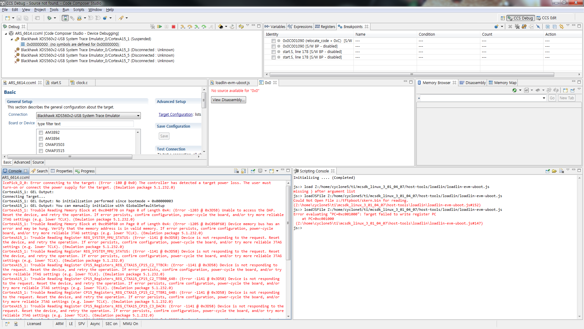

  • Hi Shankari
    Thanks for your reply. and I do that your advice. but error still remain.
    I loaded the JS file. and  I ready for  U-boot load to memory. but error is occurred.
    script console says
    Error evaluating "PC=0xc001000": Target failed to write register PC
    at PC=0xc001000
    (Z:\home\cyclone5\ti\mcsdk_linux_3_01_04_07\host-tools\loadlin\loadlin-evm-uboot.js#147)
    and console says
    IcePick_D_0: Error connecting to the target: (Error -180 @ 0x0) The controller has detected a target power loss. The user must turn-on or connect the power supply for the target. (Emulation package 5.1.232.0)
    CortexA15_1: GEL Output:
    Connecting Target...
    CortexA15_1: GEL Output: No initialization performed since bootmode = 0x00000003
    CortexA15_1: GEL Output: You can manually initialize with GlobalDefaultSetup
    CortexA15_1: Trouble Reading Memory Block at 0xc048f70 on Page 0 of Length 0x4: (Error -1203 @ 0x3D5B) Unable to access the DAP. Reset the device, and retry the operation. If error persists, confirm configuration, power-cycle the board, and/or try more reliable JTAG settings (e.g. lower TCLK). (Emulation package 5.1.232.0)
    CortexA15_1: Trouble Reading Memory Block at 0xc050f60 on Page 0 of Length 0x4: (Error -1205 @ 0xC050F60) Device memory bus has an error and may be hung. Verify that the memory address is in valid memory. If error persists, confirm configuration, power-cycle board, and/or try more reliable JTAG settings (e.g. lower TCLK). (Emulation package 5.1.232.0)
    CortexA15_1: Trouble Reading Register REG_SYSTEM_MMU_STATUS: (Error -1141 @ 0x3D58) Device is not responding to the request. Reset the device, and retry the operation. If error persists, confirm configuration, power-cycle the board, and/or try more reliable JTAG settings (e.g. lower TCLK). (Emulation package 5.1.232.0)
    CortexA15_1: Trouble Reading Register CP15_Registers_REG_CTXA15_CP15_C2_TTBCR: (Error -1141 @ 0x3D58) Device is not responding to the request. Reset the device, and retry the operation. If error persists, confirm configuration, power-cycle the board, and/or try more reliable JTAG settings (e.g. lower TCLK). (Emulation package 5.1.232.0)
    CortexA15_1: Trouble Reading Register CP15_Registers_REG_CTXA15_CP15_C2_TTBR0_64B: (Error -1141 @ 0x3D58) Device is not responding to the request. Reset the device, and retry the operation. If error persists, confirm configuration, power-cycle the board, and/or try more reliable JTAG settings (e.g. lower TCLK). (Emulation package 5.1.232.0)
    CortexA15_1: Trouble Reading Register CP15_Registers_REG_CTXA15_CP15_C2_TTBR1_64B: (Error -1141 @ 0x3D58) Device is not responding to the request. Reset the device, and retry the operation. If error persists, confirm configuration, power-cycle the board, and/or try more reliable JTAG settings (e.g. lower TCLK). (Emulation package 5.1.232.0)
    CortexA15_1: Trouble Reading Register CP15_Registers_REG_CTXA15_CP15_C3_DACR: (Error -1141 @ 0x3D58) Device is not responding to the request. Reset the device, and retry the operation. If error persists, confirm configuration, power-cycle the board, and/or try more reliable JTAG settings (e.g. lower TCLK). (Emulation package 5.1.232.0)
    CortexA15_1: Trouble Writing Register PC: (Error -1141 @ 0x3D58) Device is not responding to the request. Reset the device, and retry the operation. If error persists, confirm configuration, power-cycle the board, and/or try more reliable JTAG settings (e.g. lower TCLK). (Emulation package 5.1.232.0)
    Help me please.
    Shin.
