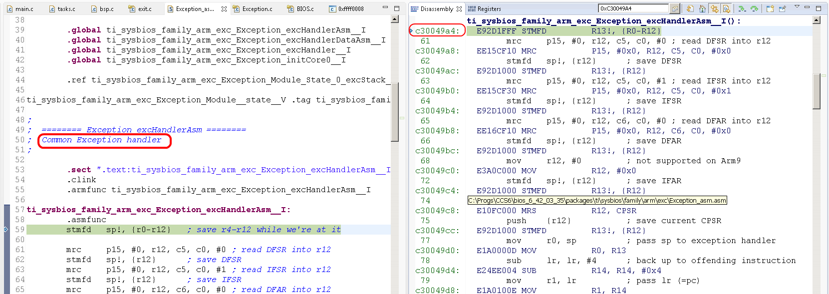

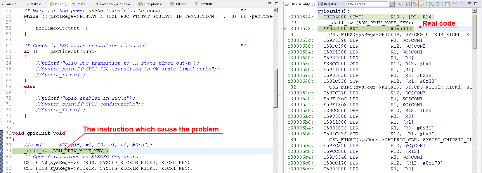

I try to switch ARM core wich works with SYS/BIOS into the privileged mode by instruction:
_call_swi(ARM_PRIV_MODE_KEY);

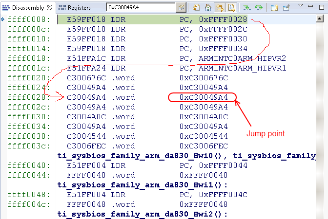

but it leads to falling into an exception handler. The problem is that there is an address of the subroutine of exception situated in the appropriate vector of SWI #0x50000. Why do it situated there? How to switch ARM core into the the privileged mode?

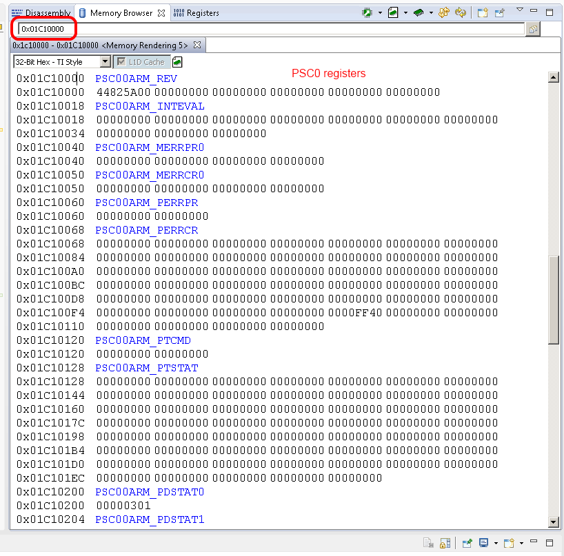

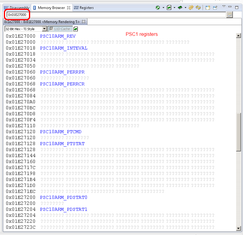

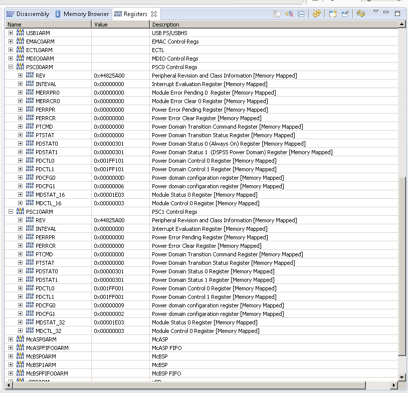

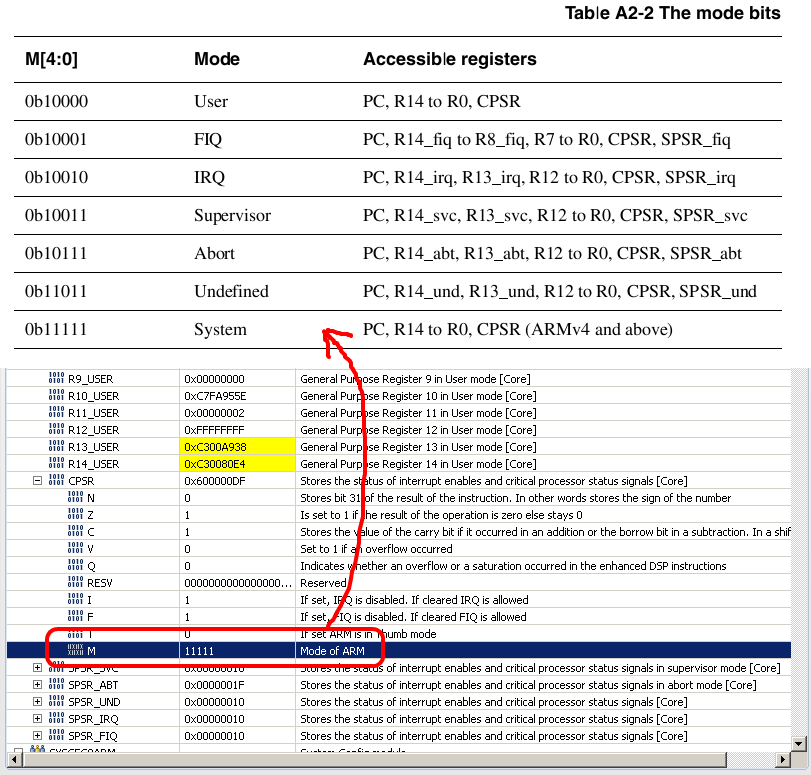

  • Ok. I found out some information. My ARM core is running on SYSTEM mode. I can access to some registers through memory, but can't to another ones. I still can see them and can change their value in a 'Registers' view of CCS. When I try to watch them in a 'Memory Browser' view of CCS I've got an array of '?'.
    There are some screenshots:
    1) ARM is in the SYSTEM mode:
    2) I have an easy access to registers through the 'Registers' panel

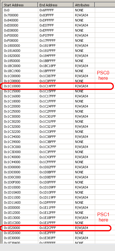

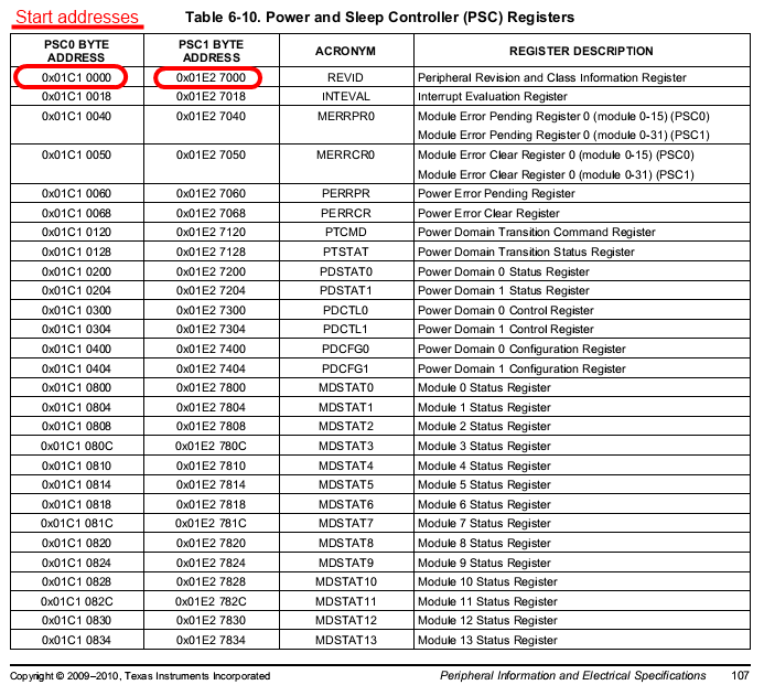

    3) There is a part of OMAP-L138 datasheet which shows the memory map of PSC0 and PSC1 modules:
    4) This is a memory view of PSC0 registers:
    5) This is a memory view of PSC1 registers:
    6) This is a screenshot of the memory map in my CCS project:
    It looks equally for PSC0 and PSC1 parts of memory. If the processor tries to write in PSC1 registers it falls into a trap.

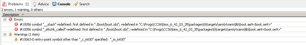

  • I've tried to do it before and I found out that this library is incompatible with SYS/BIOS (I didn't get into main() function and even couldn't stop an execution of the code).
    So I guess the right way is the injection into my project the source file boot.asm from bios_6_42_03_35\packages\ti\targets\arm\rtsarm\ location and correction it.
    I tried to do that but it was unsuccessful: the project has its own definitions from thr same file which was included as SYS/BIOS library.
    As you can see, the problem is a library from SYS/BIOS which is called boot.oe9.
    I hope if I can remove it from my project (or even exclude it from the build) I'll reach success, but I can't understand how to do it. Any ideas?

  • Fortunately, I realized what the problem was. It wasn't a problem with ARM privilege! It was just a problem with MMU module - it wasn't configured right.
    There is a piece of advice how to configure MMU in a right manner:
    https://e2e.ti.com/support/embedded/tirtos/f/355/t/193050#pi317008filter=answers&pi317008scroll=true
