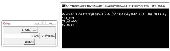

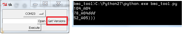

    The versions of UCD now look like the following:
    - UCD9090_104_A04
    - UCD9244_78_A04
    - UCD9244_52_A05
    If you don't have further suggestions, we will initiate RMA for this EVM.
    Naoki

  • Hi Naoki
    Our K2H EVM cannot be powered up by using the version you suggested or previous version. My post is here.
    e2e.ti.com/.../501788
  • Xining,
    We are seeing success with the patched script file as highlighted by Naoki.  The screen output in your post appears to have garbled characters.  There may be an additional platform or OS compatibility issue that you are encountering.
    Our draft modified script file is attached.  Please run this from a Windows PC to see if you get success.
    Tom

  • Yes, you are right.
    I should change the file. I was thinking, the bmc_tool.py is up to date, but it is not.
    Thanks!

  • Guven,
    Thanks for the insight.
    Javier,
    As suggested, make sure that you have the latest bmc_tool.py file dated 2016.  The earlier one truncated long command strings and then provided a false indication of programming success.  All of the needed files are available on the Advantech website http://www2.advantech.com/Support/TI-EVM/EVMK2HX_sd4.aspx
    Tom

  • Javier,
    Can you also run the bmc_tool.py and the hit get version to confirm that the UCD update has happened correctly. I have updated 15-20 EVMs recently for some internal evaluation and didn`t see this issue.
    After updating the UCD firmware this is what I see on the UCD firmware
    Hope this helps. Let us know if this is not what you observe as the version number string for the UCD firmware.
    Rahul
  • Thank you for your responses, but  as I stated in my first post I was already using the latest versions of the command files and also fixed the input line length issue in the bmc_tool.py script. These are the version numbers that are reported after the upgrade:
    which are indeed the same as those in Rahul's answer.
    Maybe it's time to return the EVM for a closer inspection.
    Javier
  • Javier,
    The version numbers are not sufficient.  These can be valid.  However, if the wrong bmc_tool.py program is used which deletes long strings, the configuration is corrupted and the UCD power convertors will not work correctly.  However, since you claim that you have correctly updated the bmc_tool.py program and it still fails, then you should initiate a return for replacement.  I have been persistent because we have never had a unit that was not recovered by the revised configuration.
    Tom
