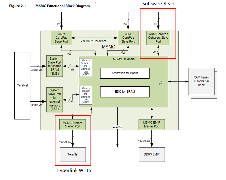

    I just want to be sure that there is no concurrent memory access on the same data buffer. It does not seem that there is any locking principle for Hyperlink per default. If one Soc board is reading its local data buffer that the remote side is accessig through hyperlink, how can I be sure that there is no concurrent access?
    One is accessing thank memory mapping from the user space and the other one thank hyperlink peripheral which triggers a VBUSM master write operation.
     I would say that they can be in conflict if I do not use any locking or lock-free algorithm.
    Regards, dpa

  • Thanks Eric for you answer,
    How can you be sure that all data arrived? And how do you know?
    By my example code above, the data buffer is placed in SRAM handled by the MSMC. I suppose that it ensures integrity of my data when reading.
    But is it blockwise?
    In other words, can it happen that the reader is reading a memory block at the same time a block transfer is initiated by the hyperlink due to writing operation? It means that I won't have data consistency: by reading, part of data would be already new and rest of it would still not be updated.
    My understanding of this topic is limited, it can be a simple question for a simple answer.
    I want to have 100% assurance that I have data integrity but also data consistency.
    Damien
    I summarized below what I understood of the way it is working.
    Is it correct?
    If yes, how is the arbitration done when reading and writing at the same time?

    My question was more to understand concurrency generally speaking in the context of hyperlink: how a local read and a remote write (with hyperlink) operations are handled by using the memory mapped example from the MCSDK.
    To be more specific, let me just ask one question then:
    By using the memory mapped example from the MCSDK with a data packet of less than 256 bits, can I be sure that a local read on ARM and a remote write through Hyperlink are performed atomically?
    I know that I can use interrupt packet of Hyperlink and hardware semaphore for example, but I want to understand how it is working to be sure that I won't overengineer a solution if it is already ensured per hardware design that a so small packet is read/written atomically.
  • Do I need to open a new thread for this specific questions?
  • dpa,
    It is possible to make that a local read on ARM and a remote write through Hyperlink are performed atomically. We may need to give Hyperlink master priority on Teranet, so ARM can't read the buffer in the middle of the write access. This needs more to explore.
