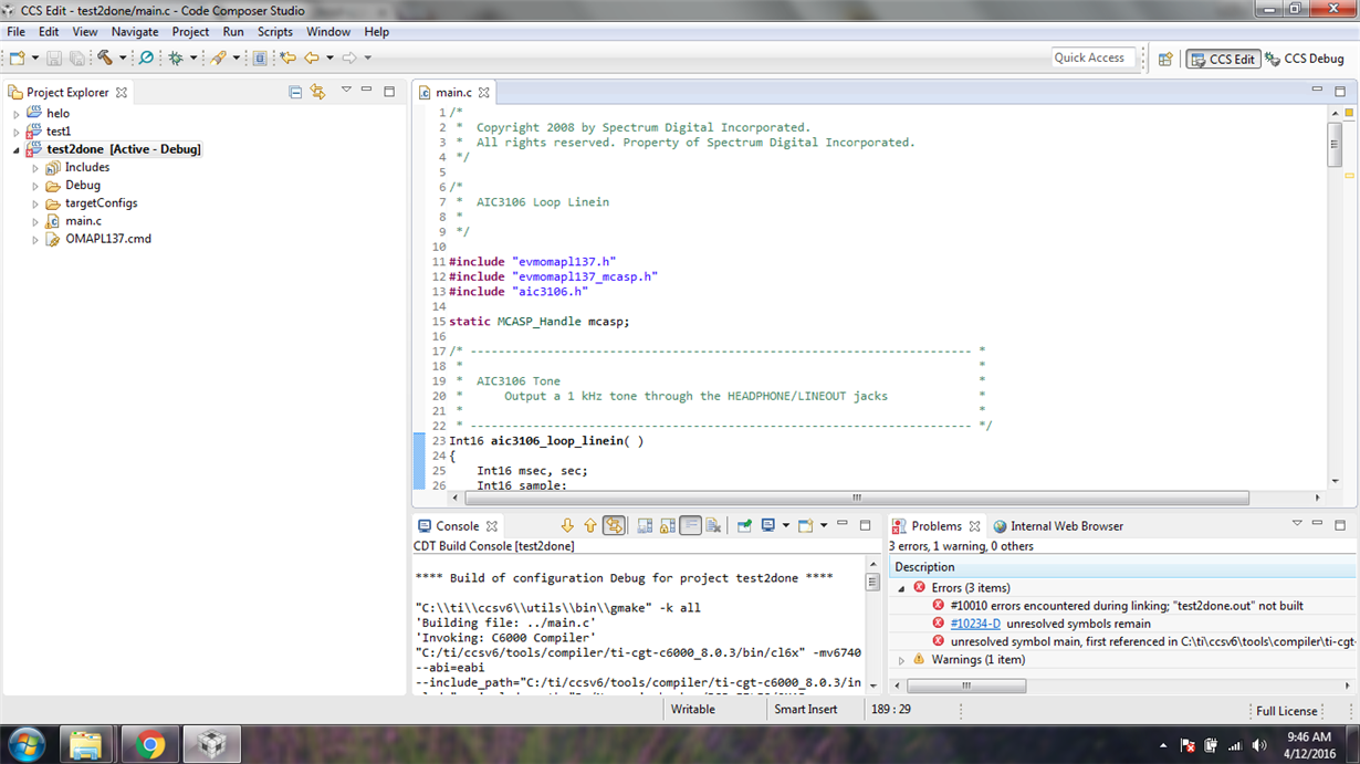

I am working with the example "aic3106_loop_linein" standard program.....i have added the path for headers
evmomapl137.h"
"evmomapl137_mcasp.h"
 "aic3106.h
1)"D:\Naseer's backup\DSP FILES\OMAP L137\2818.revg_EVMOMAPL137_BSL\evmomapl137_v1\dsp\include" and
2)"D:\Naseer's backup\DSP FILES\OMAP L137\2818.revg_EVMOMAPL137_BSL\evmomapl137_v1\dsp\tests\aic3106".
I have not at all addedd any libraries and  linker command file.My runsupport library is  <automatic> and compiler version is 8.0.3......

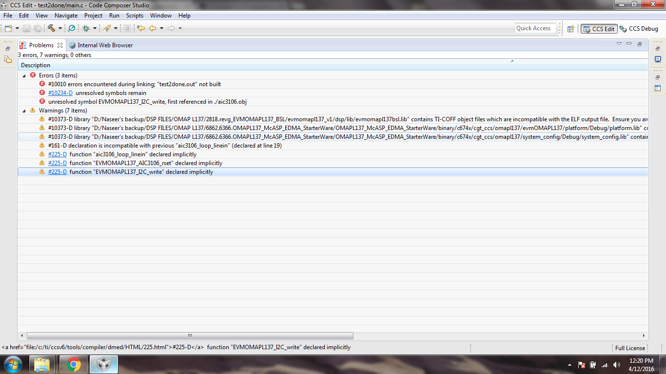

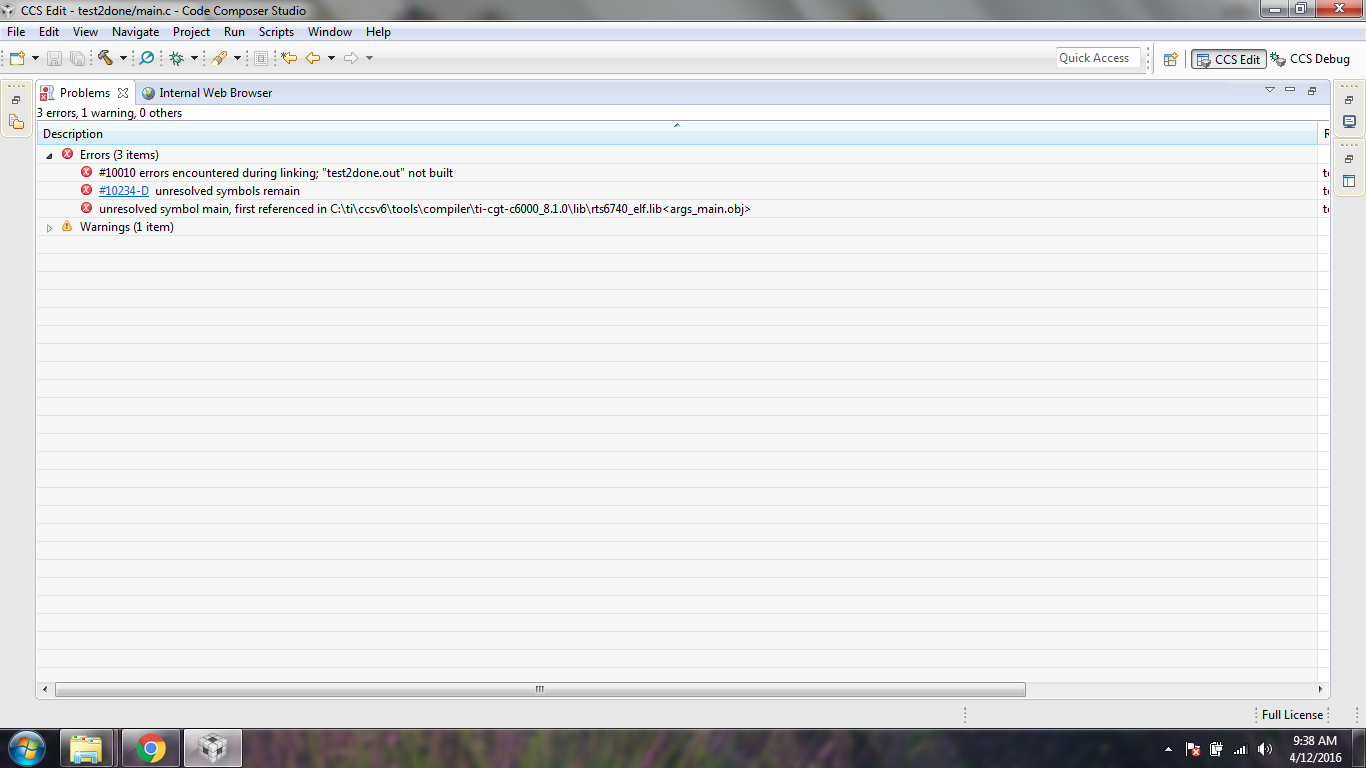

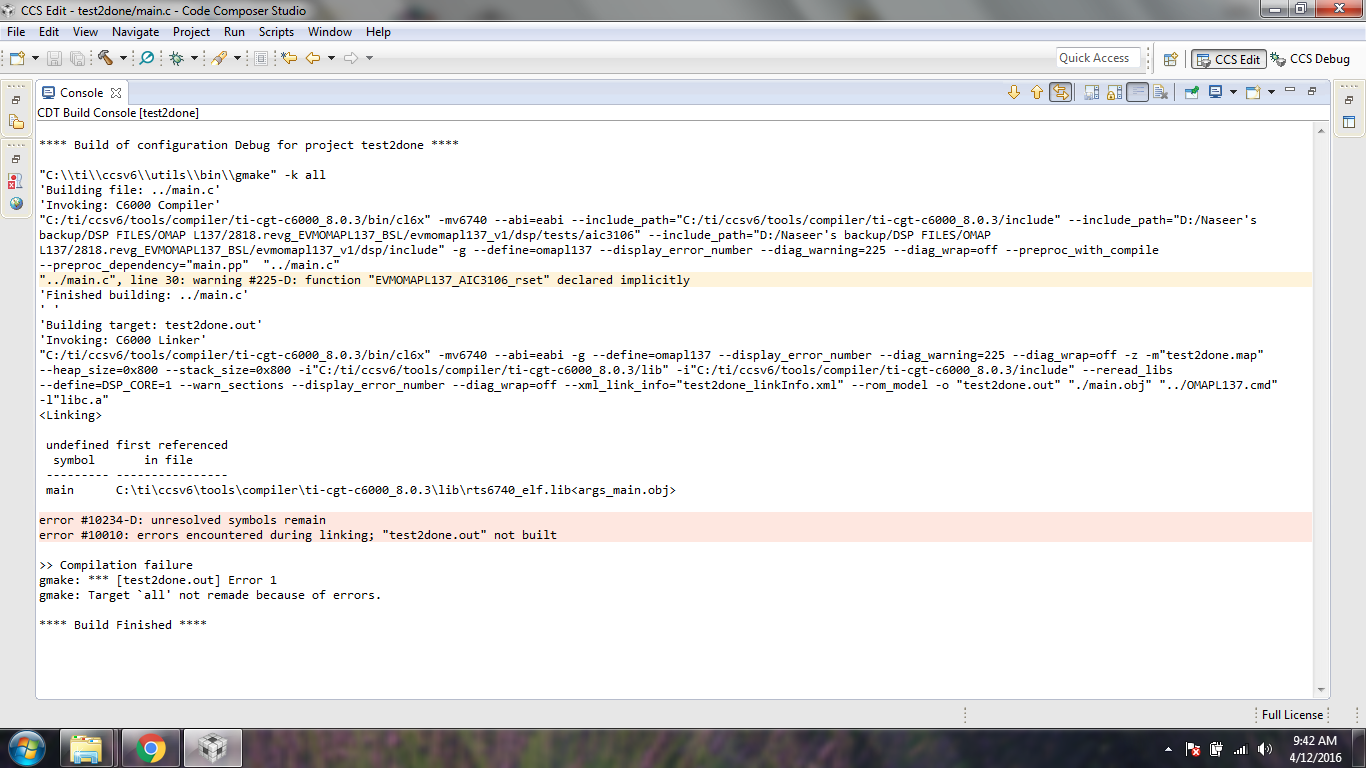

Then i am getting the errors like
Description Resource Path Location Type
#10010 errors encountered during linking; "test2done.out" not built test2done C/C++ Problem
<a href="file:/c:/ti/ccsv6/tools/compiler/dmed/HTML/10234.html">#10234-D</a> unresolved symbols remain test2done C/C++ Problem
unresolved symbol main, first referenced in C:\ti\ccsv6\tools\compiler\ti-cgt-c6000_8.0.3\lib\rts6740_elf.lib<args_main.obj> test2done C/C++ Problem
How to over come with this

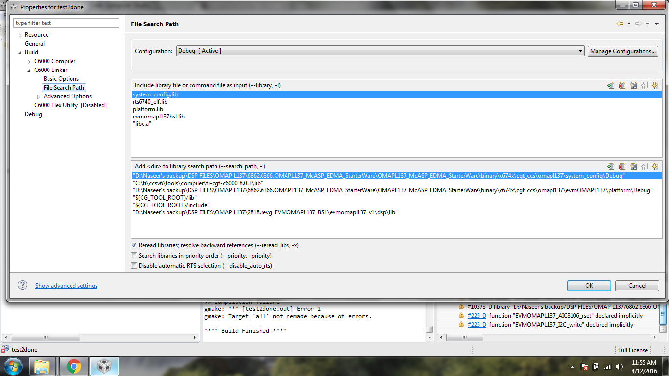

  • I have added "evmomapl137bsl.lib" but the result is same....
  • Hi Mohammad,
    1. Check in which file, the function, EVMOMAPL137_AIC3106_rset is defined. And check whether that file is included. If not, include it.
    2. Check whether "rts6740_elf.lib" is included in the project properties-->linker -->File search path.
    And more over, you have to specify the details like the name of the TI package in which this example enclosed and the version of the TI package. So that we will guide you more how to build the project using CCS.
    -->>I am unable to find "rts6740_elf.lib" ,where i ll get it.......but i changed my run support library as rts6740_elf.lib.Is this fine...?
    thank you
    I found "rts6740_elf.lib" and added to my project....but still same error....see the attachment....

  • I have checked your files, your main.c file doesn't have "main()" API which is required to build executable.
    Use like this in your main.c file.
    int main(void)
    aic3106_loop_linein();
    while(1);
  • Hi Titu,
    I have added the lines what u sent,but still the same 3 errors......code.docx

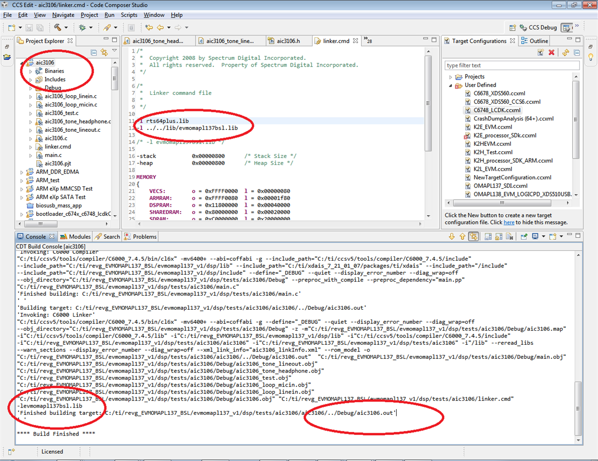

  • I'm able to build your project after I have added the following files into "test2done" project.
    evmomapl137_gpio.c
    evmomapl137_i2c.c
    evmomapl137.c

  • Hi Naseer,
    Able to reproduce your problem and build the "    from "revg_EVMOMAPL137_BSL" pacakge successfully.
    Basically you have two issues. One is the compilation issue and the other one is the linker issue.
    Compilation issue:
    warning #225-D: function "EVMOMAPL137_AIC3106_rset" declared implicitly.
    Cause: The main.c is not able to find the declaration of the function, " "EVMOMAPL137_AIC3106_rset".
    Solution : Go to aic3106.h and add the declaration as below:
    Int16 EVMOMAPL137_AIC3106_rset( Uint16 regnum, Uint16 regval );
    Linker issue:

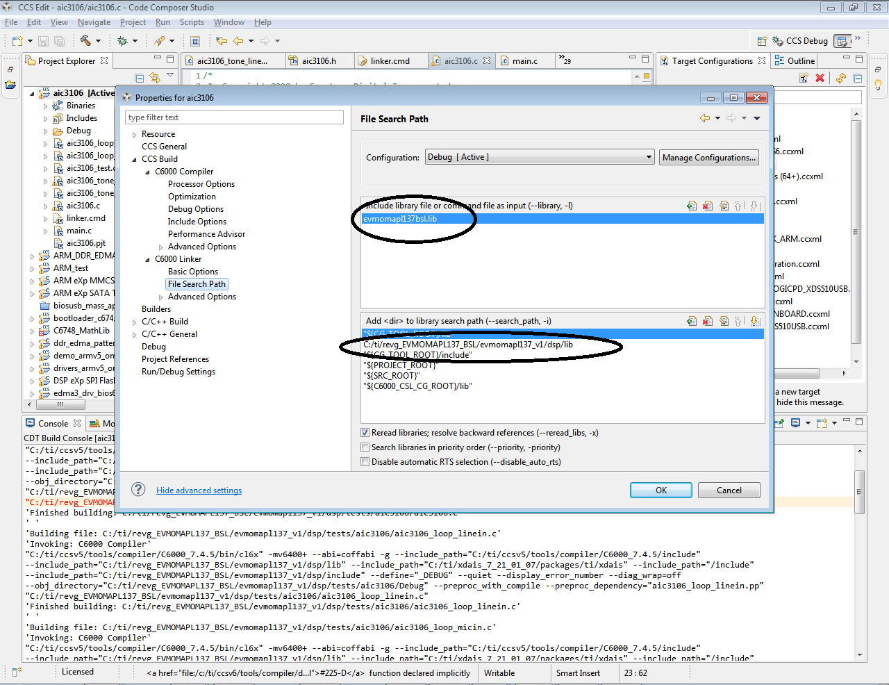

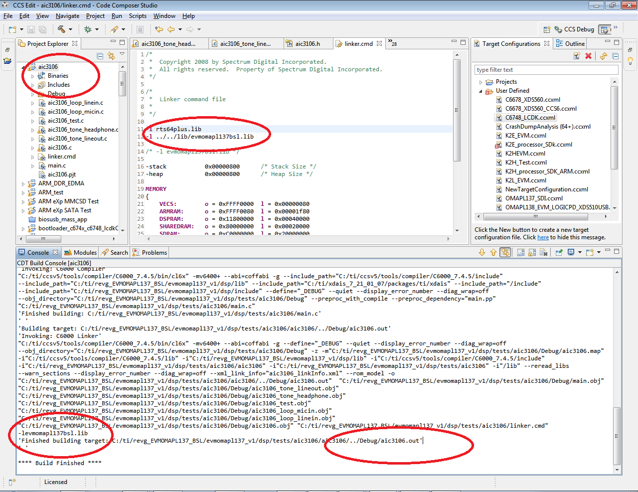

    1. You added the library file correctly. But notice that the path is specified using the "\". It should be "/".
    2. Once you do this, you can get rid of te linker error.
    2. If you get any compatibility error on "evmomapl137bsl.lib", You have to impor the library project and rebuild it too.
