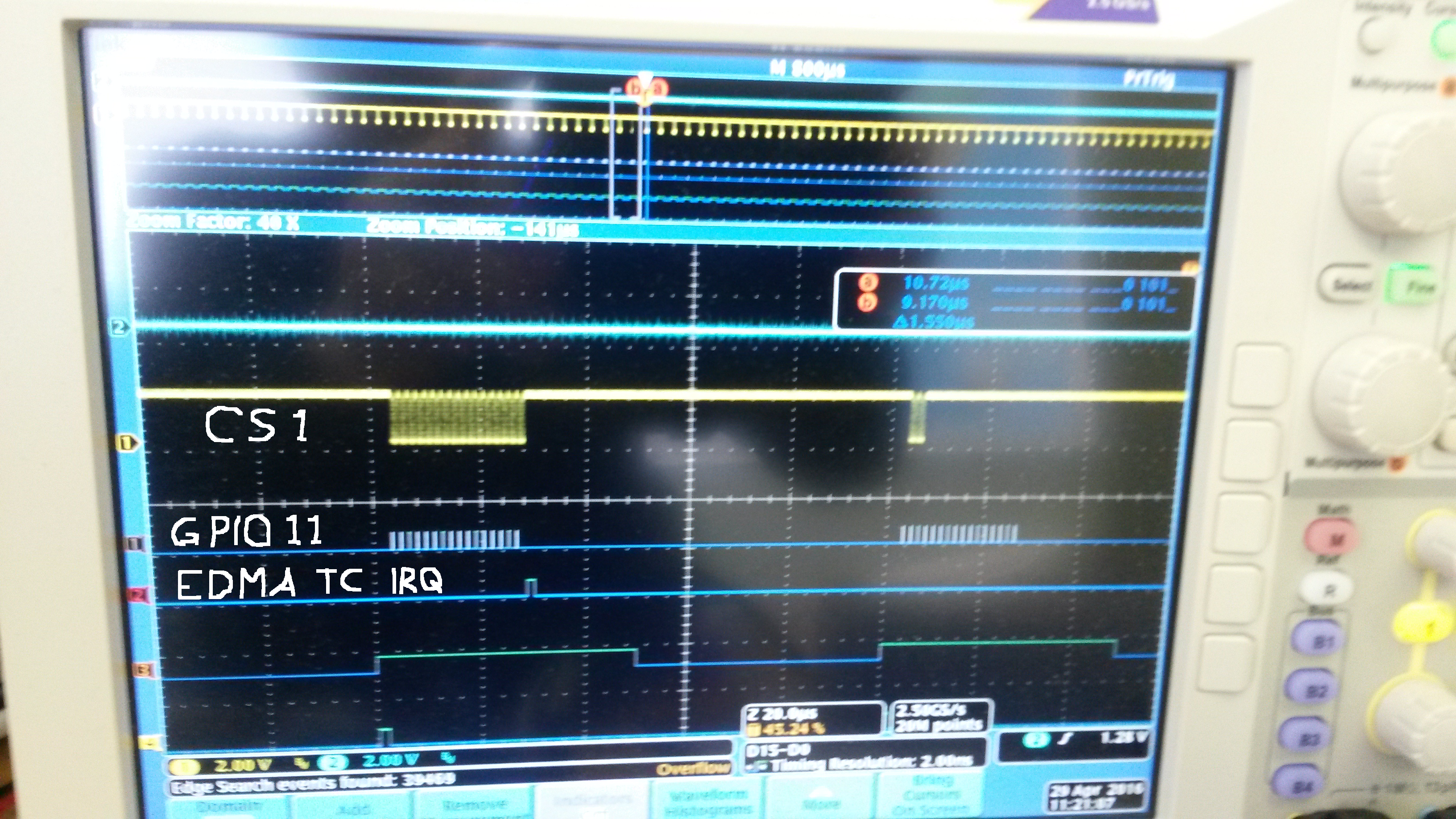

I am using the 6638 K2H EVM board rev 4.0. I need to do some AB-synchronized DMA transfers periodically from the EMIF16 memory to the DDR3 memory..
The problem now is that the EDMA sometimes stops reacting to the incoming sync. events. This happens in average to the every 3000th of transfers.
Example:
My peripheral gives 16 sync inputs to the EDMA through the GPIO 11 pin. Each of these 16 events trigger a transfer of 2 X 12 bytes. I repeat this procedure once per second (or 10 000 times per second, it does not matter). It succeeds most of the time.
But then, at some random moment, only 2 events are processed (it's not always 2, it varies randomly between 1-15). When stopping the software with the debugger into the spot where it prepares the next transfer there are never any errors visible in the EDMA error registers, but I can see that the CCNT register in the PaRAM is still > 0; 14 in this example case. With the debugger I can give more events for the EDMA by writing into the ESR-register and the EDMA reacts to them alright --> the CCNT decreases by one after each write.
Below is an oscilloscope image of the problem.
There are 2 transfers visible in the image above,. As seen, the EDMA processes the first transfer OK, but then during the 2nd transfer it suddenly stops working. The peripheral gives all the 16 pulses nicely in both of the cases, but the 2nd transfer the EDMA reacts only to 2 of them.
What can stop EDMA working? As told above there are no visible errors in the EDMA registers but the CCNT still has 14 events to receive and the transfer can still be continued by manually triggering the event with software/debugger.

    thanks for your reply.
    I am sorry, but I don't fully understand why you suggest using chained transfers instead of an AB-synchronized transfer.
    I program the OPT field of the PaRAM to 0x80113004 (TCINTEN = 1, TCC = 0x13). This is the way it has already worked for years in my earlier DM6443 platform. Now I just want to do the same with the Keystone 2. I do not want to start using chained transfers because a single AB-sync is good enough for me. In addition, if my configuration was wrong, then also all the 3000 now successful transfers would fail in the same manner, right?
    I did another test this morning: I disabled the HW input from the peripheral and triggered the GPIO 11 only by software by calling the EDMA3 LLD function EDMA3_DRV_enableTransfer(hEdma, 19, EDMA3_DRV_TRIG_MODE_MANUAL). The EDMA configuration was exactly the same where it fails with 1/~3000 transfers when externally triggered.
    I let it run for ~15 minutes and then stopped. The missed event count was 0 out of 8984421 transfers. So the problems seems to come from the electrical interface only. I suspected first if some other CPU (4 ARMs and 7 other DSPs) interferes with my transfers, but this test should clearly prove that it is not the case.
    I will try the same with another EDMA controller and another GPIO pin to see if it behaves any better.
    Ari
    the EDMA3 CC2 with the GPIO pin 0 gives good results. I can now run the system for several minutes without one single error.
    It appears that the EVM board connects the GPIO pins 0...16 to a host processor (LM3S2D93) in 2 banks: pins 0...7 and 8..15. The lower bank seems to be more stable for application use than the upper bank for some reason. So it is better to use GPIO pins 0...7 for EDMA inputs.
