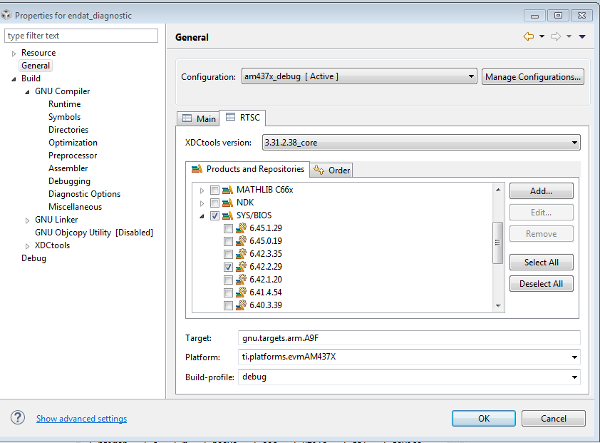

  • Hi David;
        Now having problems building the LLD\pruicss_drv et. al. as a ARM lib to access the PRUs. Is there a ready made CCS project file? I tried to concoct my own but there are so many paths and dependancies that I'm not sure everything is being included with the correct paths nor which versions match. I am getting deep down in the xdc tools 'undefined' errors on some of the core structs. I'll list what I have built with:
    bios_6_45_01_29, sysbios_ind_sdk_2.1.1.2, xdctools_3_32_00_06_core
    looks like basic types from types.h are not being found. i.e. xdc_bits16, xdc_bits32, IGate_Provider_Handle, etc.
    Any clues on how this is supposed to fit together?
    Thanks for your time,
    Aaron Kellner
  • Hi Aaron
    It is important to use the correct set of CCS, SYSBIOS and XDC Tools. Oher combinations are not guaranteed to work.
    From the on line version of the user guide http://processors.wiki.ti.com/index.php/SYSBIOS_Industrial_SDK_02.01.01_User_Guide
    The recommendations are
    • Code Composer Studio version CCS 6.1.1.00022 -   I have used CCS 6.1.2 without issue.
    • Industrial SDK version 2.1.1
    • SYS/BIOS 6.42.2.29 Real Time Operating System
    • XDC Tool 3.31.2.38_core
    • NDK 2.24.3.35  - not needed for this application
    • Compiler GNU v4.8.4 (Linaro) - provided as part of CCS
    David

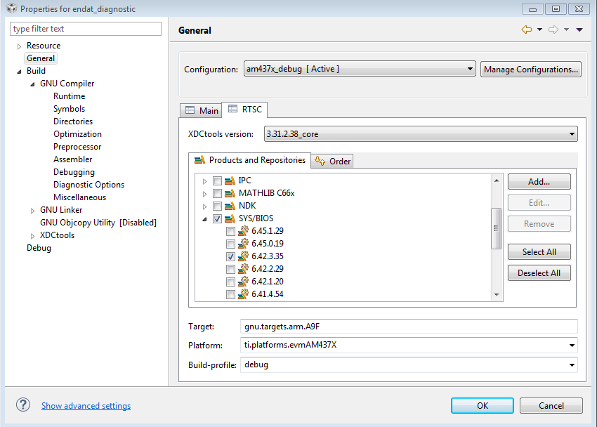

  • Hi David;
    Thanks again for your reply. I have the correct XDC tool version, but the download package for sys/bios comes with the newer versions. How do I find the old ones?
    Aaron Kellner
  • Hi David;
       I was hoping it would have been as easy as downgrading to the matching version, but no, still not building. Any other suggestions? Maybe a makefile somewhere I could use as the template?
    Aaron Kellner

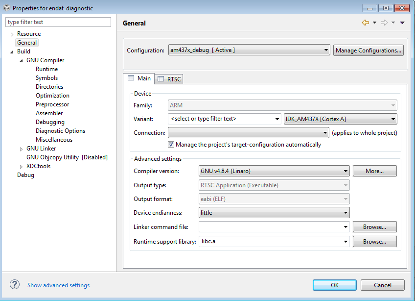

  • Hi Aaron
    The Endat_diagnostic is a good example of what is needed.
    I usually build with a AM437x IDK specific configuration as shown below. I remove any linker command file references.
    David

    I beat the compile problem down to a compile time error in HWI.H. The preprocessor error is "#error "target not supported by legacy HWI module". Further analysis showed that the Sitara doesn't seem to be supported by the •SYS/BIOS 6.42.2.29 Real Time Operating System that is recommended in the Software list in your earlier post. Further the directory trees are really quite different between the 6.42 and 6.45 versions making selective use problematical. I see in this post you are using 6.42.3.35. Is that version supporting the Sitara? Or another waste of time? It's clear this sys_bios_driver lib is key to the ARM/PRUSS integration. Can you please advise on the build?
  • Hi Aaron
    I apologize the SYSBIOS version should be  SYS/BIOS 6.42.2.29. It was a incorrect selection on my part.
    David
  • Hi David;
    As I mentioned, the version you quote above 6.42.2.29, doesn't work for the Sitara. I did however get it to compile. Had to do 2 things. 1) Build with 6.45.00.19, a step below the current rel, and modify BIOS.H to eliminate the conditional compile around the PREFIX ALIASES since there was no reason not to include them in the build. Then I got an absolutely clean build except for a warning on the rel version on an out of range index in the EMAC section. Analysis showed it may be intentional so I left it.
    Quite a battle.
