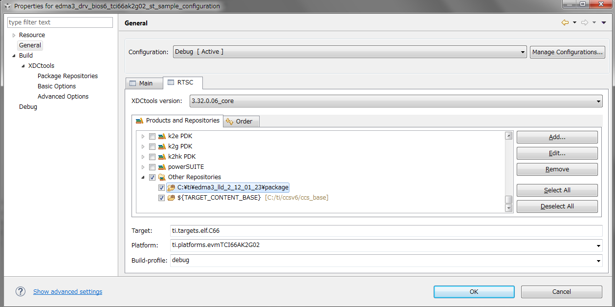

I'm now trying to build the example code delivered from edma3_lld_2_12_01_23. I imported edma3_drv_bios6_tci66ak2g02_st_sample and edma3_drv_bios6_tci66ak2g02_st_sample_configuration to CCSv6.1.2 and build them.
It seems some path configurations are not correct, so I fixed them as below:
1. Add the repository for edma RTSC pacakge in edma3_drv_bios6_tci66ak2g02_st_sample_configuration

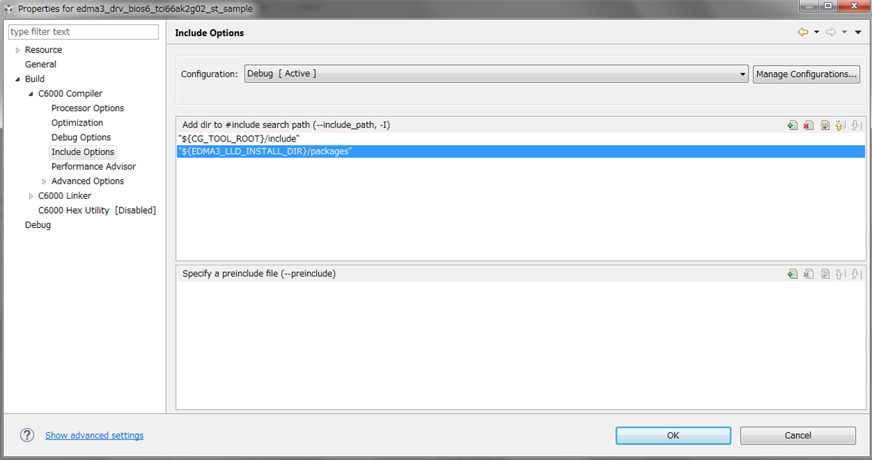

2. Add variables in edma3_drv_bios6_tci66ak2g02_st_sample
3. Add include options for header files  in edma3_drv_bios6_tci66ak2g02_st_sample
And then built the projects.The compilation itself looked done correctly, but in link phase, I saw the following error:
What is indicated by these error? And how can i fix this problem ? I think you can recreate the issue at your end.
