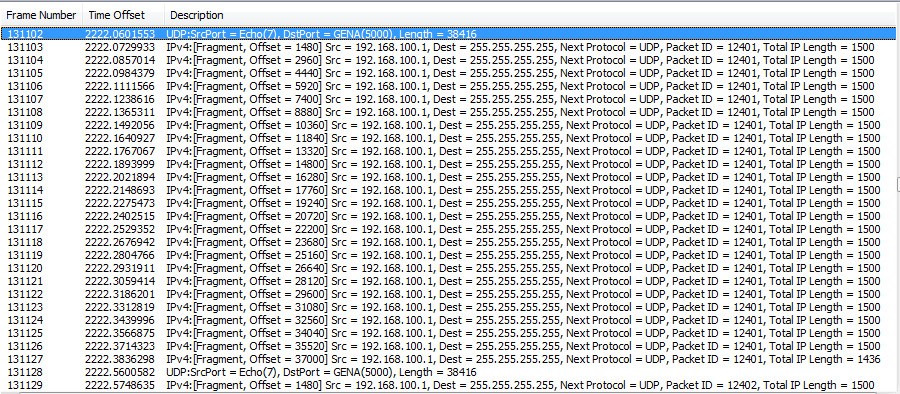

I'm sending the same 32KB packet via both TCP and UDP for comparison, looking at the timing with Microsoft Network Monitor. The TCP fragments are all sent in about 15ms while the UDP fragments are taking about 15ms EACH, about a factor of 20 slower. Is there a setting I can adjust to send UDP fragments at a higher rate? Thanks!

  • Let me add some more information. I'm using NDK 1.93 (maintaining a legacy project) and UDP packet fragmentation appears to be working properly. Here's a sample trace from Microsoft Network Monitor:
    I can see all the data going out, my complaint is the time delay (10 to 15 milliseconds) between fragments. When I look at a trace for TCP packets of the same size the fragments are closely-spaced but these are being spread out. Seems like something in the IP layer of the NDK must be inserting the delay between UDP fragments, it's below anything I'm doing.

    I have to apologize, I don't think I clearly expressed my issue, I'll try again... :)
    This is a private network dedicated to the application I'm developing, no other traffic. I can see the data getting across just fine with both Microsoft Network Monitor and with my application. There is no packet loss, all of the data is making it from one end to the other. It doesn't matter whether I use TCP or UDP, both fragment/reassemble my large packets and get the data across reliably (because my network environment is locked down).
    It's the difference in the time BETWEEN fragments being sent that I'm wondering about. My understanding is that both TCP and UDP are layers on top of IP, and the IP layer is what does the fragmentation. When a TCP packet gets fragmented there is less than 1ms between fragments going out on the wire, but when a UDP packet gets fragmented there is 10 to 15ms between fragments. If the IP layer is handling fragmentation of both, why is there a factor of 20 in the amount of time between fragments?
    -- Carl
