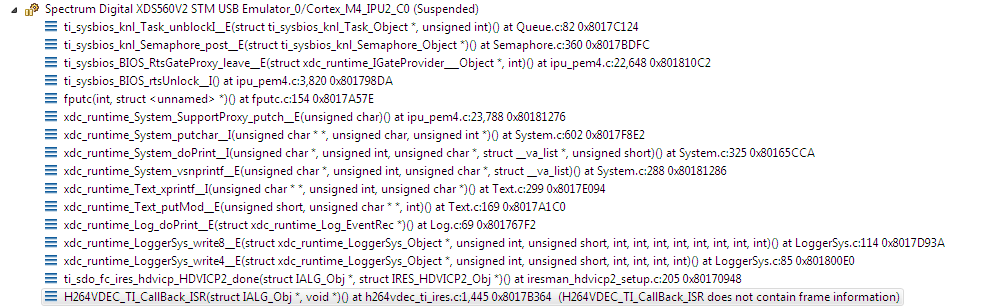

I have simple encoder and decoder application running on IPU2 (sysbios) directly. My application uses the TI HDVICP encoder and decoder. At times, I observe a crash inside the codec process call. I am running this application using CCS and have obtained the following stack trace.
[t=0x00000001:216346d7] ti.sdo.fc.ires.hdvicp2: [+E] ti_sdo_fc_ires_hdvicp_HDVICP2_w[t=0x00000001:21c3584d] ti.sdo.[t=0x00000001:21f682ed] ti.sysbios.family.arm.m3.Hwi: ERROR: line 1078: E_hardFault: FORCED
ti.sysbios.family.arm.m3.Hwi: line 1078: E_hardFault: FORCED
[t=0x00000001:22cce0b1] ti.sysbios.family.arm.m3.Hwi: ERROR: line 1155: E_busFault: PRECISERR: Immediate Bus Fault, exact addr known, address: f1016017
ti.sysbios.family.arm.m3.Hwi: line 1155: E_busFault: PRECISERR: Immediate Bus Fault, exact addr known, address: f1016017
Exception occurred in background thread at PC = 0x8017c124.
Core 0: Exception occurred in ThreadType_Swi.
Swi name: {unknown-instance-name}, handle: 0x80610678.
Swi stack base: 0x8060c570.
Swi stack size: 0x3000.
R0 = 0xf1a00204 R8 = 0x00000006
R1 = 0x00000000 R9 = 0x00000000
R2 = 0xf1016013 R10 = 0x00000000
R3 = 0x8060f80c R11 = 0xffffffff
R4 = 0x00000000 R12 = 0x00000010
R5 = 0x00000001 SP(R13) = 0x8060f2f8
R6 = 0x80610878 LR(R14) = 0x8017bdfd
R7 = 0x0000002e PC(R15) = 0x8017c124
PSR = 0x61000000
ICSR = 0x00435803
MMFSR = 0x00
BFSR = 0x82
UFSR = 0x0000
HFSR = 0x40000000
DFSR = 0x00000000
MMAR = 0xf1016017
BFAR = 0xf1016017
AFSR = 0x00000000
Terminating execution...

I get a call trace as below
What could the issue be? Any inputs provided would be very valuable.
Thank you.

    Additionally, I observe that I had enabled all the logs while running the application. I don't see this issue when the logs are disabled. Is this some kind of timing issue?
    Apoorva
  • Hi Apporva, yes it seems a timing issue. I will try to find someone in TI familiar with PSDK 02_00_00_00
