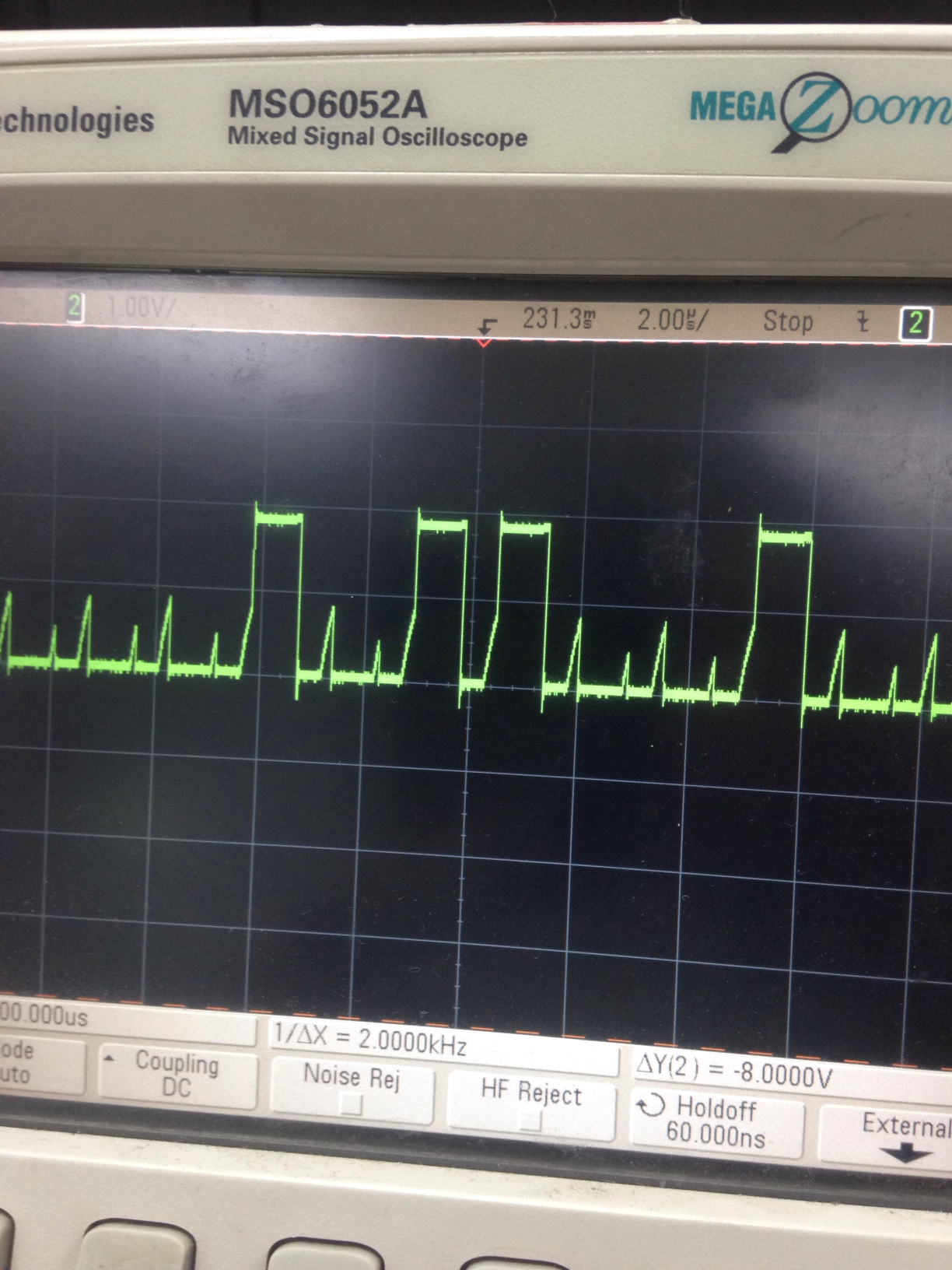

Our single board has the following questions:
OMAP-L138 set NAND8 start-up boot mode, all the object files, such as UBL, uboot, kernel and rootfs are placed inside the NAND flash, when the bootloader in the start-up phase, we tested the NAND flash signal integrity, such as the signal of EMIF_D0, found with half height level. Such annex.
Now back in NAND two kernel, there is a lot of kernel CRC validation failure in the use of the process, the need to re download in the UBOOT to return to normal. We suspect that there is a certain relationship and NAND signal integrity.
Accessories for the schematic, please help check轨道交通车载台实验板(M30P1)电路图.pdf

    Our products have been mass production based on OMAP-L138,Most of the products can work normally,A small amount of product will appear kernel CRC failure,Reading and writing NAND is normal, we have a backup  5 copies of UBL, 2 copies of UBOOT, 2 copies of Kernel, 2 copies of rootfs in the NAND Flash.
    The main issue is Kernel CRC check failure occasionally, the system will stay in the uboot phase,We are looking for the main cause of the problem.Since we have used MCP (NAND + mDDR) in my design,May i reset the register of NAND flash after UBL?Or we have to modify the schematics,and use a new NAND flash base on TI official recommendation?
    The following is the system log:

    //Before that, the NAND signal quality was poor.
    Starting kernel ...
    Uncompressing Linux... done, booting the kernel.
    //After that, the NAND signal quality was good.
    Please help check,thanks a lot!

    //NO, we checked the contents of the NAND using nanddump,we see some bytes difference between the original image.we must be reload kernel image for working normal.
    Now,We have a relatively stable product(Module: D8135)based on OMAP-L138,There is some EMI filters in emifa bus,so We did not find the kernel CRC validation failed. and NAND signals is good.
    Unfortunately,Other products based on OMAP-L138 have some kernel crc failure,The signal waveform of NAND is shown in the appendix.
    I added code at UBL,The signal waveform of NAND is good, but UBL can not bootup,log as follows:

    do you think we have to solve the problem of NAND signal waveform?

    After flashing the kernel again on problematic board, then NAND signal wave form is proper now ??
    Edited:
    I hope, No, its because this problem is due to ECC bitflips but not with NAND signal.

    To confirm that this is not ECC or bitflip issue and its due to NAND signals are not proper,
    Can you try to patch the u-boot for the ECC which I have mentioned in the above TI e2e post and try to reflash the u-boot (not kernel) which has the fix and see if the board is booting with older kernel itself...
    I hope the u-boot is not capable of correcting the ECC bitflips and hence, not able to boot, once you reflashed the kernel via UART, ECC is rewritten with newer kernel image and booting.

    I added NAND_Init code in UBL,the nand signal wave is good.but failed at NAND_open.
  • You can also add some prints if any bitflips found by u-boot and see whether u-boot is able to correct it and add printfs in those u-boot's ECC functions.
    So that you can understand what's going on inside to the u-boot ECC mechanism.
    I think, your u-boot is not able to find the bitflips, that's why its simply load and run the kernel thus cause the CRC failure.
    If its able to find the bitflip error then it would correct the bitflip and allow to load & run the kernel.
    I have seen similar issues with older u-boot version.
    You can do one more thing that try to make 1 or 2 bitflips (0 -> 1 or 1 -> 0) in kernel area (some how) and see u-boot is able to find and correct the bitflips (remember to add the printfs respective u-boot's ECC functions)
