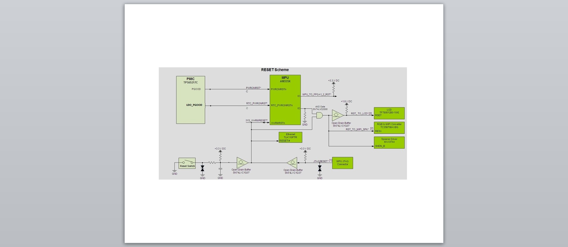

AM335X reset scheme with TSP65217C for RTC timer functionality but no RTC-only mode:
I am using RTC timer functionality but no RTC-only mode. Please check if attached reset scheme and pin connections  for EXT_WAKEUP, CAP_VDD_RTC, VDDS_RTC, RTC_KALDO_ENn are ok.
I am again writing my connection here for RTC timer functionality but no RTC-only mode:
PGOOD will be connected to PWRONRSTn
PGOOD will be connected to RTC_PWRONRSTn through open drain buffer with 1.8V pull up. As per AM335X checklist ,page no 6. We are also not using LDO1(TPS65217C) to connect it to VDDS_RTC.We are connecting VDDS_RTC to LDO3. Please confirm this connection as  your suggestion. RTC_PWRONRSTn is connected to LDO_GOOD.
PGOOD willbe connected to WARMRSTn through buffer or open drain buffer as per refrence schmetic of beagle bone considering the fact that there is a small chance that on power up the nRESETOUT signal on the processor may go high, causing the SYS_RESETn signal to go HI before it should. This change reinforces the reset with the PORZn reset signal.

  • Here is the correct way to connect given your use condition:
    Also, please review the application note below:
    www.ti.com/.../slvu551i.pdf

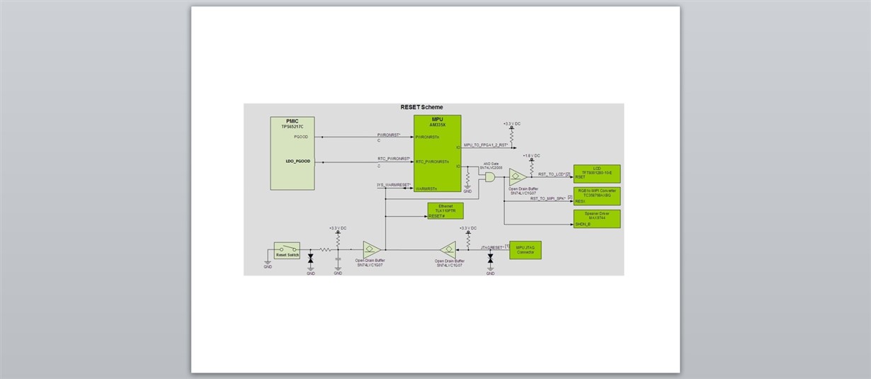

  • The picture did not make it earlier. Trying again.
  • Hi Sivak,
