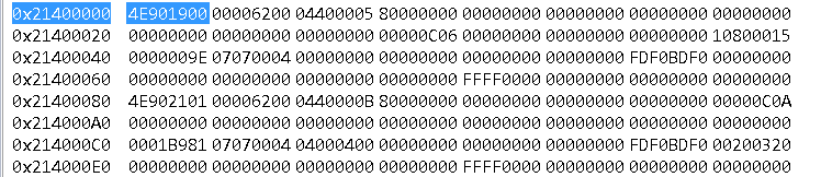

  • We have one 66Ak2hk14 and 3 TMSC6678 in our board.
    So i tested with K2HK and c6678 only.
    I am using pdk_keystone2_3_00_03_15 and mcsdk_bios_3_00_03_15 for K2HK.
    And pdk_C6678_1_1_2_6 mcsdk_bios_3_00_03_15 for TMSC6678.
    Do these package have any difference with the latest one ?
  • Will ask experts to support further.
    Thanks for your patience.
  • There is no issue for Hyperlink between KS II and KS I devices. We have customer with such product. Please describe how the 1 KS II and 3 C6678 connected for Hyperlink?
    What is the reference clock of 66ak2h14 and C6678? Please try to run 6.25 Gb or 3.125Gb rate first before trying 10Gb. The mapping is both way and read/write also worked both way. Can we debug the connection between KS2 port 0 and KS1?
    Regards, Eric
    Thanks for your reply,
    We are using reference clock of 156.25Mhz and trying at 6.25Gb.
    Loop back within KS1 and KS2 worked fine.But external loop back from KS1 to KS2  fails. Attached the log.
    As i mentioned earlier, I am using CCS-5.5 for compiling pdk_keystone2_3_00_03_15 (K2HK) package and using CCS-5.3 for compiling (CC678) pdk_C6678_1_1_2_6.
    Also attached our hyperlink connection between the KS1(dsp1) and KS2(dsp2) .

  • The typical working case Hyperlink register dumps likes below:
    21400000: 4e902101 00006000 04400005 80000000    .!.N.`....@.....
    21400010: 00000000 00000000 00000000 00000c0a    ................
    21400020: 00000000 00000000 00000000 00000000    ................
    21400030: 00000000 00000000 00000000 00000000    ................
    21400040: 0002b981 07070004 04000400 00000000    ................
    21400050: 00000000 00000000 fdf0bdf0 00200320    ............ . .
    21400060: 00000000 00000000 00000000 00000000    ................
    21400070: ffff0000 00000000 00000000 00000000
    In your log:
    [C66xx_0] Version #: 0x02000009; string HYPLNK LLD Revision: 02.00.00.09:Nov 24 2013:17:32:20
    About to do system setup (PLL, PSC, and DDR)
    Power domain is already enabled.  You probably re-ran without device reset (which is OK)
    Constructed SERDES configs: PLL=0x00000250; RX=0x0046c485; TX=0x000cc305
    system setup worked
    About to set up HyperLink Peripheral
    ============================Hyperlink Testing Port 0
    ========================================== begin registers before initialization ===========
    Revision register contents:
      Raw    = 0x4e902101
    Status register contents:
      Raw        = 0x00003004
    Link status register contents:
      Raw       = 0x00000000
    Control register contents:
      Raw             = 0x00000000
      Raw        = 0x00000000
    ============== end registers before initialization ===========
    Waiting for other side to come up (       0)
    [C66xx_0] Waiting for other side to come up (       1)
    There is no link from K2H to C6678 at all. ""HYPLNK LLD Revision: 02.00.00.09:Nov 24 2013:17:32:20: is very old, please use latest one from Processor SDK 3.0 release.
    [C66xx_8] Version #: 0x01000105; string HYPLNK LLD Revision: 01.00.01.05:Nov 19 2012:16:04:15
    Constructed SERDES configs: PLL=0x00000250; RX=0x0046c485; TX=0x000a0305
    system setup worked
    ============== begin registers after initialization ===========
      Raw        = 0x04400005
      Raw       = 0xccf00cff
      Raw             = 0x00006200
    ============== end registers after initialization ===========
    Waiting 5 seconds to check link stability
    Precursors 0
    Postcursors: 19
    Link seems stable
    About to try to read remote registers
    C6678 side, the intialization seems correct, but as K2H side problem, the link is not coming up. I am surprised how you can do one direction transfer?
    As you have four SOC on the board, can you explain K2H port 0 is connected to ? K2H port 1 is connected to ? From diagram, it looks that only K2H PORT 0 connected to C6678 via Hyperlink?
    Regards, Eric

  • Hi Titus,
    I checked the hyperlink functionality with latest sdk package between K2HK port 0 and C6678 port 0 for 3.125 serial rate.
    It looks K2HK getting failed during transfer and C6678 is getting passed during block transfer at 3.125.
    At 6.25,both K2HK and c6678 hangs.
    I have attached complete log,
    Please suggest ,

    You need to dump register from 0x2140_0000 to 0x2140_007c to make sure offset 0x4 and offset 0x58 looks right. Offset 0x4: no reset, no loopback, no serial stop, offset 0x58 = 0xfdf0bdf0. You can also look at http://www.ti.com/lit/an/sprac37/sprac37.pdf section 4.4 for more tips.
    https://e2e.ti.com/cfs-file/__key/communityserver-discussions-components-files/791/hyplnk_5F00_exampleProject.out
    https://e2e.ti.com/cfs-file/__key/communityserver-discussions-components-files/791/hyplnk_5F00_K2HC66BiosExampleProject.out
    Regards, Eric
  • I also attached a working case register dump for you reference:
    0x2140_0000 to 0x2140_007c is C6678 side
    0x2140_0080 to 0x2140_00FC is K2H side mapped into C6678 side, equavalent to itself's 0x2140_0000 to 0x2140_007C
    Regards, Eric
