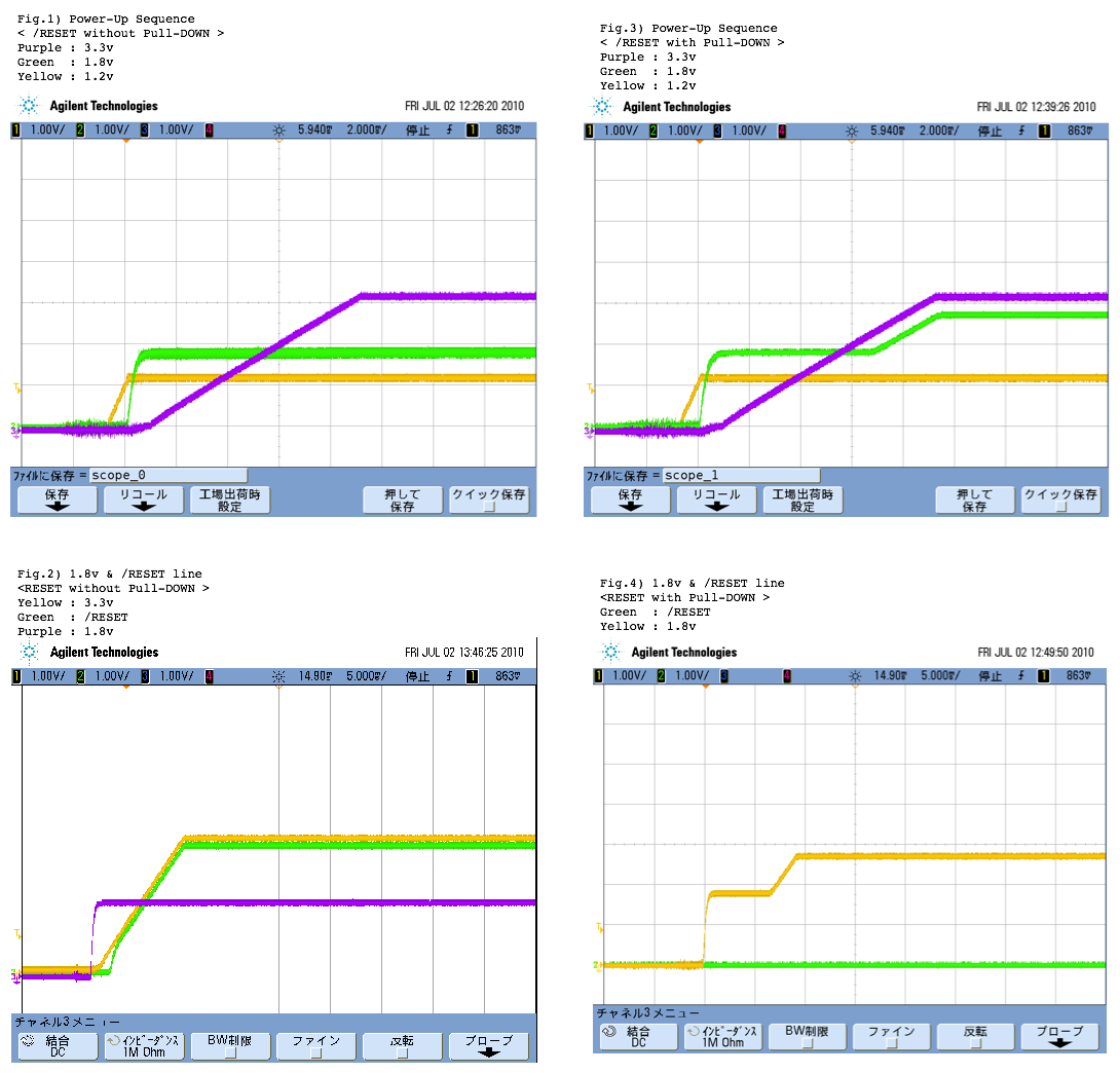

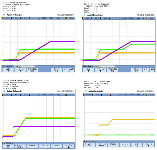

  • For my grounds in the previous post, I will attach a copy of screen from the measuring instrument.
    Fig1) and Fig.2) show that, /RESET without PULL-DOWN, /RESET line goes up to 3.3v synchronizing with 3.3v and 1.8v stays correctly 1.8v.
    Fig3) and Fig.4) show that, /RESET with PULL-DOWN, /RESET line is held low without any glitch and 1.8v goes up to 2.6v.
  • Hi Kato-san
    Thanks for providing the snapshots of you reset and power sequencing. A few comments
    1) In general I would still recommend that you have the device reset hooked through a reset supervisor circuit or use the resetout/pgood signal to tie to the c6748 /RESET rather then directly tying it to 3.3V
    2) I can' t necessarily make out from the figures if the slew rate for the 3.3V has changed between Fig1 and Fig3 , can you confirm?

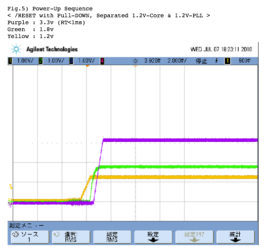

    Bingo! The rise time for the 3.3V line is more than 8ms. After changed to less than 1ms, 1.8V to 2.6V ramp-up is not observed even if the /RESET has the pull-down and 1.2V pll is isolated from 1.2V core. I will upload Figure 5 which shows no ramp-up problem.

  • Hi Mukul-san
    Here's a few additional information for your investigation.
    • Ganging the 1.2V supply was not an effective solution for this issue in some our boards.
    • This issue does not occur in the power sequence of 3.3V->1.8V->1.2V or 3.3V->1.2V->1.8V even if the rise time of 3.3V supply is more than 8ms.

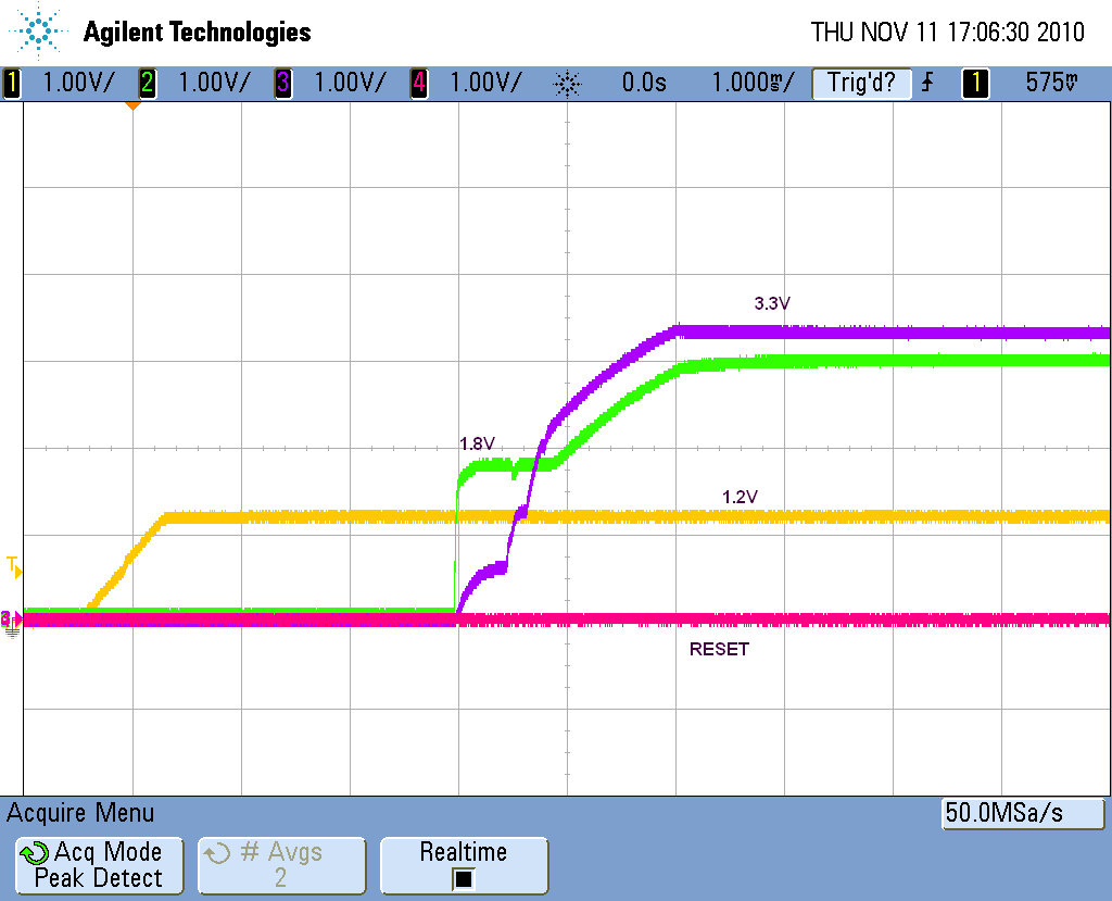

  • Mukul,
    My TI field apps engineer is Jason Brand in the UK. I asked him to chase this a couple of hours ago by email so any info you could give him would be helpful.
    I tried the fixes suggested in this thread with no luck. If I put a 2.048V shunt reg on the 1.8V rail it just pulls the 3.3V rail down & when I remove it the 1.8V rail will go up to 3V. This is the first PCB of this job so I cannot be completely sure there is no other issue with the PCB. The processor is TMX320C6748. Of course it's also possible that the processor on this PCB is now damaged because the 1.8V limit has been exceeded, but I don't want to swap the processor just to end up with a pile of bad devices. I tried it on one other board with the same results. Attached a shot of the power rails on the processor. The 1.8V rail is used for DVDD18, the DVDD3310_A _B _C are connected to 3.3V.
    Regards   ---   Roger
  • Roger
    Good to know you are in good hands. Have shared the internal advisory with Jason to forward to you.
    If I remember correctly DVDD18 is the only 1.8V supply in your design as you don' t use DDR2/mDDR or the USBs and were using a set of discrete LDOs? So depending on the ramp time of your 3.3V supply and the load on your 1.8V supply , you could see the issue. I am assuming the load on your 1.8V supply is very minimal. Hopefully the workaround suggested can be applied to your existing design.
