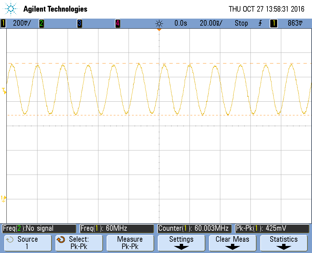

SW is reporting an EHCI lockup event where the PORTSC_I register bit 8 shows the port is in reset and will not come out. Here is the dump from our SW guy...
OK, I found the lockup. It is in USB EHCI controller at address 0x4806 4858.
The current register setting is shown highlighted in yellow below

And I finally took screen shots from the reference manual showing the port is in reset as per the register setting (see bit 8 below). Just a bit of info, when we originally put this USB stuff together this was due to the ULPI/PHY not behaving. I do not know if that is the problem today as it could also be the different HUB that has been used. I tried terminating the reset by writing a zero but the reset does not clear.
The screenshot will not copy into here, but it's just the register description from the reference manual. The PHY we are using is the USB3320 and the Hub is the USB2512 both from SMSC.
We have come to the point where help is needed. I have looked for HW issues with no luck so far. It seems to be internal to the 3703 but of course could still be hardware. Can someone help?
