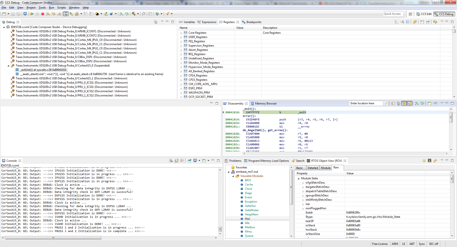

    There's no Exception tab in the Hwi section. Here's a screenshot:
    I was getting confused with the ROV for Cortex-M targets which has the decoded exception in the "Hwi" section.
    From looking at the SYS/BIOS documentation think that for Cortex-A targets the decoded exception should appear somewhere in the "Exception" section of the ROV, but don't have access to a Cortex-A to check at the moment.

    1) For a Cortex-A15 there is an "Exception call stack" in the ROV Exception view. However, found a bug which causes the Exception call stack to be incomplete - see SYS/BIOS 6.45.01.29 ti.sysbios.family.arm.exc.Exception reports incorrect SP and LR values, leading to incorrect exception call stack. There is a suggested fix in the thread.
    2) When a SYS/BIOS program terminates due to an error, or BIOS_exit being called, the stack backtrace in the debugger is incomplete and doesn't show the location of the error / exit in the application - see CCS 6.2.0.00050 doesn't display complete stack backtrace when a Cortex-A15 SYS/BIOS program using the GNU compiler terminates due to an error or calling BIOS_exit(). As a work-around setting breakpoints on xdc_runtime_Error_raiseX__E and xdc_runtime_System_exitStd__E seems to halt the program while the stack backtrace is complete enough to show the location of the problem in the application.
