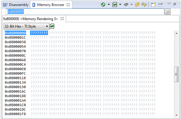

Dear Biser,
We have a custom board for AM3357 processor similar to EVM but slight difference in DDR3,
We used MT41K512M16HA-107 DDR3L device from Micron, We have routed DDR3L Signals as per BeagleBoneBlack.
Only change is we have used 8Gb Device instead of 4Gb ( MT41K256M16HA-125 ).1258.Querye2e.zip
We are using Code Composer Studio Version: 6.1.3.00034 and XDS100V2 jtag Debuger to load BeagleBoneBlack .gel file ,
which we have used the values provided by MT41K512M16HA-107 datasheet.
Problem faced while modifing DDR Address 0x800000000 = < Value >, It is not only modifing Offset 0x0, it is also manuplating offset 0x4,0x8 and 0xC.
Please find the attached files for your reference ( Querye2e.zip )
1. BeagleBlack_400Mhz_4GbDDR.gel
2. AM335x_DDR_register_calc_tool.xls
3. Console_Output.txt ( outputed console prints on Code Composer )
4. MemoryBrowser.png ( manuplating other offset 0x4, 0x8 and 0xc )

    We tried SDRAM_TIM_1=0x0AAAD4DB, SDRAM_TIM_2= 0X468F7FDA, SDRAM_TIM_3 = 0X501F88BF
    But it failed to read memory, ,
    When we tried to write on to the memory location it gave error, Please see the attached log for error

    CortxA8: Trouble Writing Memory Block at 0x8000000 on Page 0 of Length 0x4: (Error -1065 @ 0x3D5A) Unable to access device memory. Verify that the memory address is in valid memory. If error persists, confirm configuration, power-cycle board, and/or try more reliable JTAG settings (e.g. lower TCLK). (Emulation package 6.0.222.0)
    CortxA8: Trouble Writing Memory Block at 0x8000004 on Page 0 of Length 0x4: (Error -1065 @ 0x3D5A) Unable to access device memory. Verify that the memory address is in valid memory. If error persists, confirm configuration, power-cycle board, and/or try more reliable JTAG settings (e.g. lower TCLK). (Emulation package 6.0.222.0)

  • vasanth TP said:
    By defalut OCP data widthe is 128 bit as queried by reading regiser OCP_CFG_VAL_1 Register. This register is read only.
    Can we have a option to change it to 32bit instead of 128bit.
    No, this is fixed.
