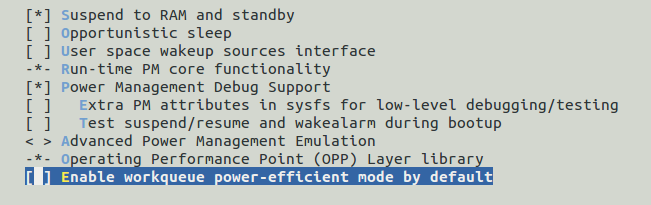

    You can try to disable runtime suspend through menuconfig:
    Power management options ---> - - Run-time PM core functionality

  • Hi Pavel,
    The Run-time PM core functionality can't be disabled. Currently setting just like this =>
    Do i have other way to disable it? or can i disable it only on I2C interface? Afterall, what i really concern is the PM effect to I2C.
    Shawn
    Seems that CONFIG_PM_RUNTIME depends on other kernel settings and can not be removed easily.
    Yes, I will suggest to try this approach first. Disable runtime suspend/resume only in I2C driver (i2c-omap.c)
    Pavel
  • Hi Pavel,
    It's works.
    First, i try to mark the "pm_runtime_enable()" at omap_i2c_probe() to disable suspend/resume, but fail. System can't boot up successfully.
    So i try to use "pm_runtime_get()" to active I2C controller, it works. I2C can receive interrupt without doing this step(let i2c-slave one to read data from non-exist device).
    Thanks for your support.
    Shawn
