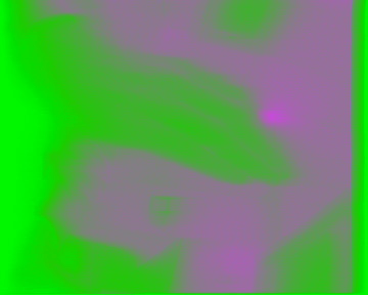

    After making these changes, I ran the dual camera application given in the SDK. This gave a display with random horizontal lines.
    I then made the following change in loopback.c of the dual camera application -
    /* Main camera display */
        strcpy(drm_device.dev_name,"/dev/drm");
        strcpy(drm_device.name,"drm");
        drm_device.width=640;
        drm_device.height=480;
        drm_device.bo_flags = OMAP_BO_SCANOUT;
        drm_device.fd = 0;
        /* Main camera */
        cap0_device.memory_mode = V4L2_MEMORY_DMABUF;
        cap0_device.num_buffers = NBUF;
        strcpy(cap0_device.dev_name,"/dev/video0");
        strcpy(cap0_device.name,"Capture 0");
        cap0_device.buffers = NULL;
        cap0_device.fmt.fmt.pix.pixelformat = V4L2_PIX_FMT_UYVY;
        cap0_device.width = 720;
        cap0_device.height = 576;
    After making these changes, the application displays video where the object boundaries can be distinguished but the colour space seems to be wrong. See attached image captured using this application.
    A PAL camera is attached to the decoder. I have verified that the pixel clock, hsync and vynsc are correct (27 Mhz, 15.625 kHz, and 50 Hz respectively).
    What could the problem be? Do I need to implement a color space converter?

  • Rajat,
    Good that you were able to at least capture something.
    I do not understand why you had to change the format order in the am437x-vpfe.c driver. To me that seems to be a bug in the application that we are working around.
    The enum_frame_sizes change to tvp514x.c was part of the patch I had sent earlier wasn't it?
    Anyhow, based on the image you attached it looks like a UYVY image but displayed as if it was a YUYV image. Again here I suspect an application issue.
    If you capture to file using "yavta -c10 -fUYVY -s720x576 -Ftest_UYVY_720x576.yuv" and then use a YUV file viewer (there are many of those on the web for instance https://sourceforge.net/projects/raw-yuvplayer/  ) and see if you can view the image properly.
  • Rajat,
    In the loopback.c file, inside v4l2_init_device() function, the capture device is still being configured as YUYV. Check this line and do modifications here as well. Hopefully, that should take care of application level issue.
    device->fmt.fmt.pix.pixelformat = FOURCC_STR("YUYV");
    Manisha
  • Manisha,
    I have changed YUYV to UYVY in the line you pointed out. Sorry I didn't mention this in my previous post.

    1) Viewing the running dual_camera application on a display. The displayed data is perfectly fine.
    2) yavta captures properly. I viewed the yuv video using vooya and it is also fine.
    This leads me to believe that the jpeg_write function in the application is not converting from yuv colorspace to rgb. Or as you said, is treating UYVY as YUVY.
    Can you tell me if the DSS handles the yuv to rgb colorspace conversion? Or can this be done with v4l2 api?
    JPEG compression happens in captured format.
    DSS handles YUV 422 to RGB conversion and that's how it is being done in dual camera demo application. The captured images are in YUV 422 format (UYVY/YUYV) and are passed to DSS. DSS does the conversion to RGB on the fly and displays on LCD/HDMI.
