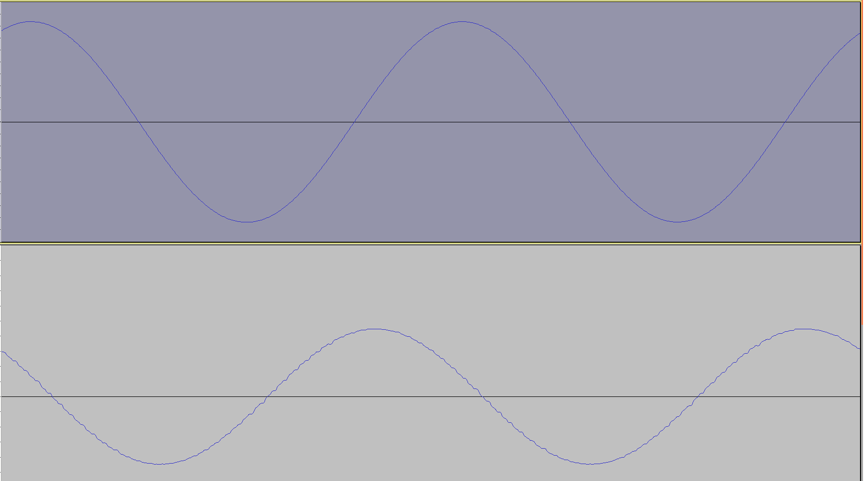

  • The explanation for DSP mode on the EVMK2G board makes sense.  But no, this has not helped the status of the board overall.
    I have come to the following conclusions:
    1) If I set the divider to 1, I can hear clear, high bandwidth audio.  If I set the divider to 32, its maximum value, I can hear extremely low bandwidth audio.  This leads me to believe that I am indeed changing the sampling rate when I set the extremes.
    2) If I set the divider to 4, I hear audio that is definitely NOT 88.2 or even 44.1KHz audio.  Attached below is an Audacity capture of a 1kHz tone.  That is, I used an external laptop to generate a 1kHz tone.  I captured the signal going into the Line input of the EVM board, and what comes out of the Line output of the EVM board.  This was taken just right now with the divider set to 4 (/* .aclkxctl  = */ 0x00000023).  This was using PDK 1.0.3.  I tried with the AIC loopback example in pdk 1.0.4, but I was getting data verification errors that I don't have time to look through.

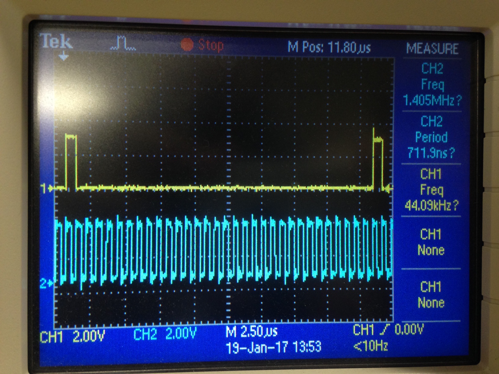

  • Justyn,
    I did some more measurements with this setup and here are my observations. I measured the bit clock ACLKX and AFSX with the default 44.1 Khz setup and here is the clock at 1411.2 Khz and the FSX at 44.1 Khz with Single slot, Wordlength of 2 as we expected.
    I then proceeded to chnage the ACLKX divider to (3) to check if the frame sync chnage accordingly and again as expected the ACLKX was observed as 2822.4 and FSX at 88.1 so the change does have the desired effect.
    I also used a known SineWave audio signal and captured the data received with the frame sync. I also hear the audio loopback working as expected with the 88.2 Khz setting Are you sure the way you are recording the audio is setup correctly?
    Rahul
  • Here is the setup.  The source is an audio interface outputting a sine wave.  The only variable that changes is adding the extra cord that goes from the EVM to the recording computer.  However, I also can plug headphones into the line out, and hear the aliasing as well.  So it's not the cable.
    I don't doubt that the clocks are working correctly, or that your math is correct.  But maybe there's something else going on here.  Maybe the LPFs on the DACs?  The impedance on the line in/outs?  I have no idea.  I know you've spent a long time on the problem, but it would be interesting if you were able to record that sine wav and provide it here.  So we could listen and view its samples such as what I did with Audacity.
    Recording the clean signal (above in the Audacity screen shot).
    Loopback (bottom picture in Audacity screenshot.
  • I had a little bit of time and recorded some more audio with a 1kHz sine wave.  This time with the divider set to 1, 32, and 8, set respectively in the Audacity screenshot.  With the divisor set to 32, I expect an audio rate of 11.025kHz.
    If my Audacity program is set to record at 96kHz, and I assume the output of the EVM board is not lowpassed, for every sample of the 11.025kHz output, my program should have ~8.7 samples representing it.
    Indeed, that's about what I see:
    I then downloaded the TLV320AIC31 manual, and there's no entries for "low pass filter" except this:
    "All performance measurements made with 20-kHz low-pass filter and, where noted, A-weighted filter. Failure to use such a filter may result in higher THD+N and lower SNR and dynamic range readings than shown in the Electrical Characteristics. The low-pass filter removes out-of-band noise, which, although not audible, may affect dynamic specification values."
    Can you confirm that
    1) The DAC has no LPF
    2) In the face of a DAC without a LPF, what I'm seeing is correct
    3) My hypothesis is correct: the output waveform is jagged because there's no LPF.  This introduces high-frequency components, which a user can hear in both 44.1 and 88.2kHz.  I mistook this for poor sample rate instead of high-frequency content (I guess aliasing wasn't the right prediction at the beginning).
    4) The AUDK2G DAC do contain LPFs.  Because I hear no high-frequency content in the AUD loopback as I do here.
  • Justyn,
    thanks for the additional experiments with this setup and also for the waveforms. Yes, the audio daughtercard is really meant for better audio output as compared the base board.
    For the AIC codec questions, can you please post your questions to Audio Converter forums:
    e2e.ti.com/.../
    I appreciate your patience with this issue.
