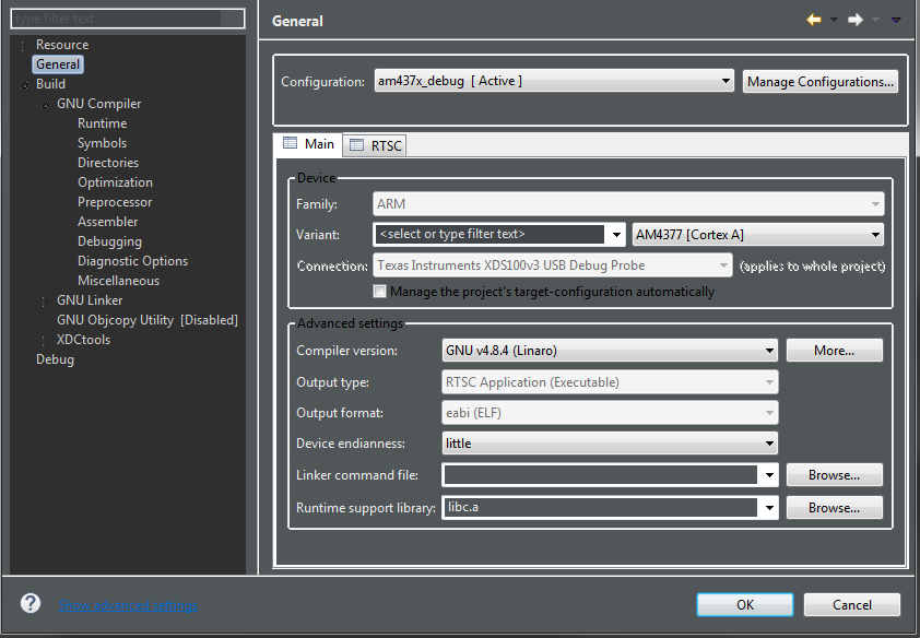

Before downloading the project I changed some project options:
As I use sysbios, the linker file should now be prepared automatically - or should I set the processor type somewhere else in the sysbios cfg file?

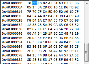

One thing that seems bad for me is problem with memory view. The DDR afer initialization looks OK:

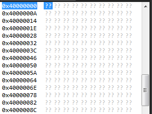

However, the rest of memory looks unaccessibly:
Maybe the memory was not initialized properly? I see no memory initialization in GEL files but there was no such initialization in original idkam437x GEL files too and there were no problems with code downloading.

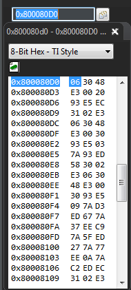

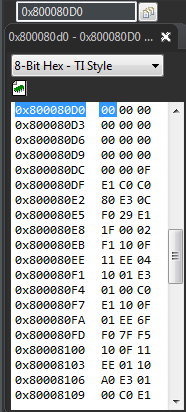

  • You may want to open a memory window to view the precise area of memory impacted.  For example, with the error reported at 800080DC you should at a minimum view 800080D0 - 800080FF.  Perhaps you could compare what's observed on your board with what's observed on an IDK.  That will help you to determine the nature of the failure, i.e. is it a bit flip, etc.
  • I watched the memory browser in both two cases and found an interesting thing.
    In IDKAM437X the code is downloaded from the start address 0x800080DC:
    whereas in the custom board the starting address is much lower and, as a result, the memory table is totally different:
    Could it be a problem that the start address is different in both cases? - I do not see any reason for that. That makes the memory table analysis quite hard.
