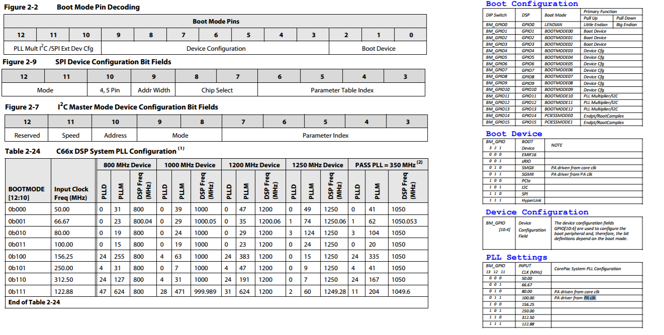

I am trying to set the bootmode of my C6678L EVM to "IBL NOR boot on image 0 (default))...this requires BM_GPIO11 to be "off", which is 1...The system boots fine. Now I want to keep the same boot mode but select the PA clk to be the code clock...this requires BM_GPIO[13, 12, 11] to be [0 1 0]...as you can see, BM_GPIO11 is conflicting with the boot mode I need...How to fix this?

  • Murad,
    I think you are mis-interpreting the BOOTMODE pins in  data sheet and schematics. The PLL setting option only applies to boot modes other than SPI and I2C. The BootROM doesn`t configure the PLLs in I2C and SPI boot modes so the PLL settings table doesn`t apply to those boot modes.
    To make my point clear, I have put together all the tables corresponding to BOOTMODE[12:0] in DEVSTAT from the datasheet. check for the interpretation of BOOTMODE[12:10], this directly corresponds to the way the GPIO pins are hooked up to the BMC.  For I2C boot the PLL setting pins are used to specify speed and address parameters.  For all other boot modes, those same pins are used to specify the PLL setting.
    So the option to drive  PA using core clock is available only on boot modes other than SPI and I2C.
