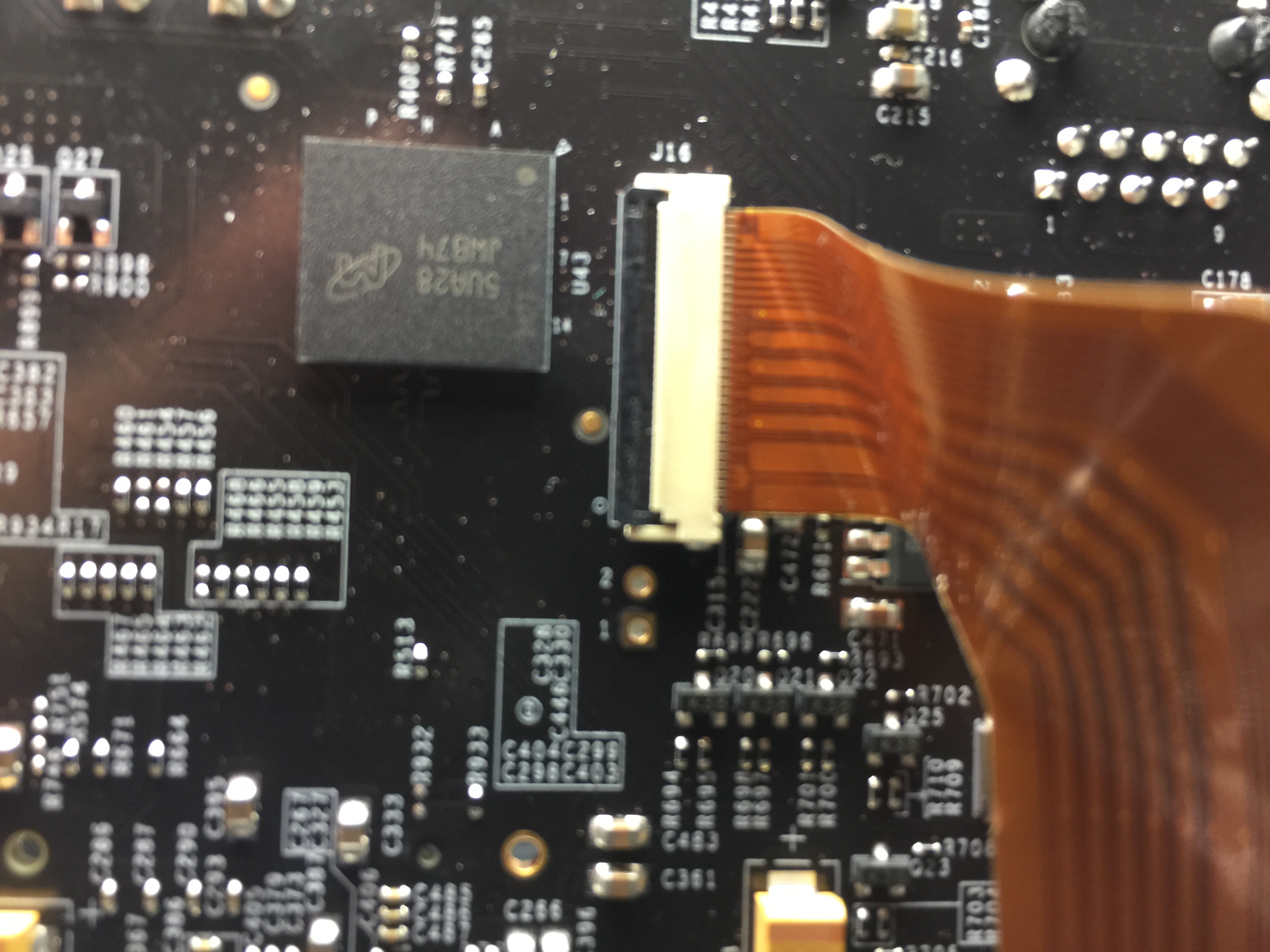

Cannot seem to get any display output on the AM5728 IDK LCD (OSD101T2587-53TS) Display. Done the due diligence of investigation involving u-boot configuration setting the device tree appropriately (in u-boot) and checking all of the ribbon cable connections as well.  At this point either the hardware is bad or I'm doing something wrong.  Hoping the latter (doing something wrong) is my problem.  Would like some basic feedback if possible such as (it works for me, or my procedure looks okay, or seem to be missing something, etc.)  Using following configuration:

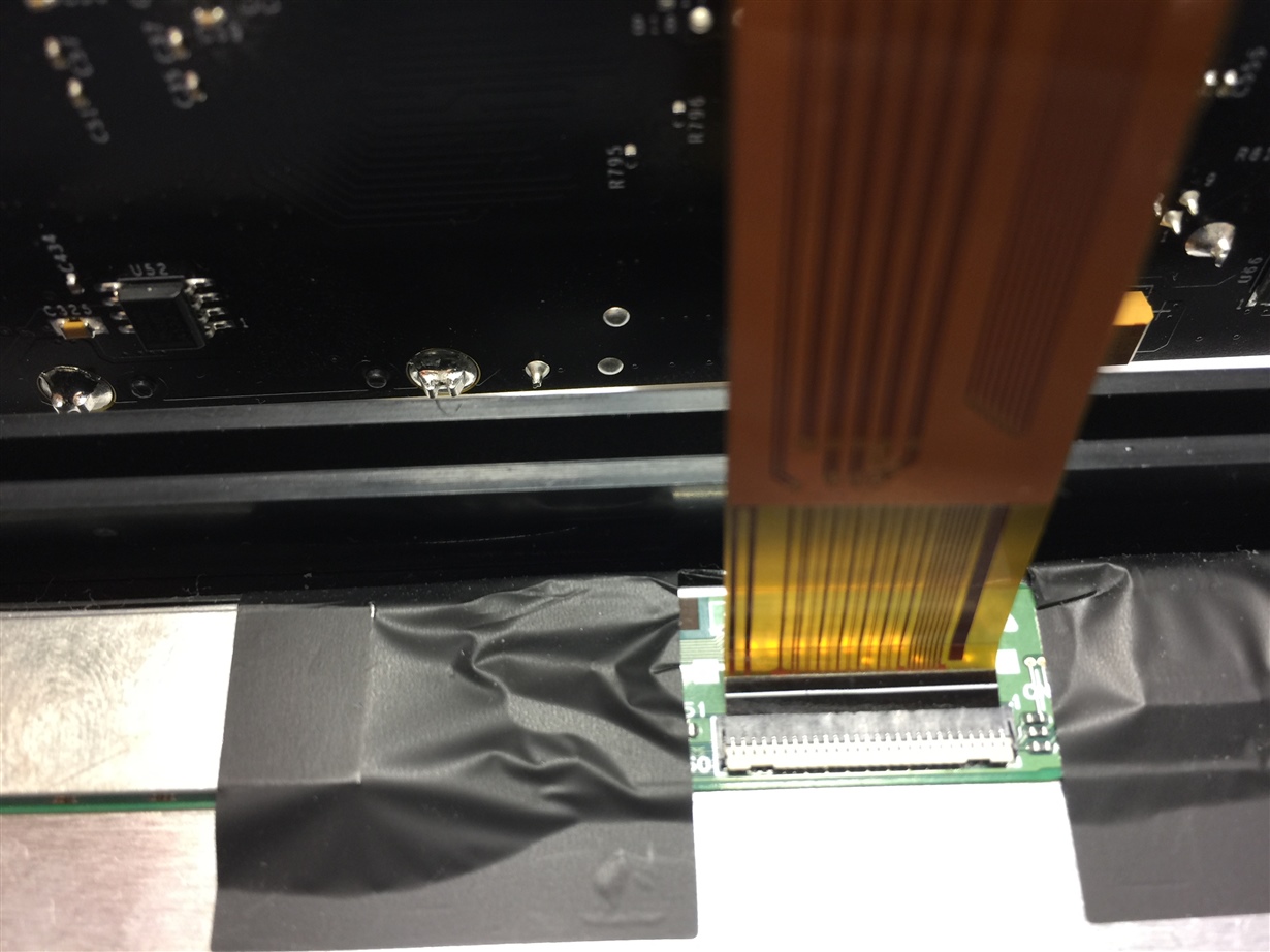

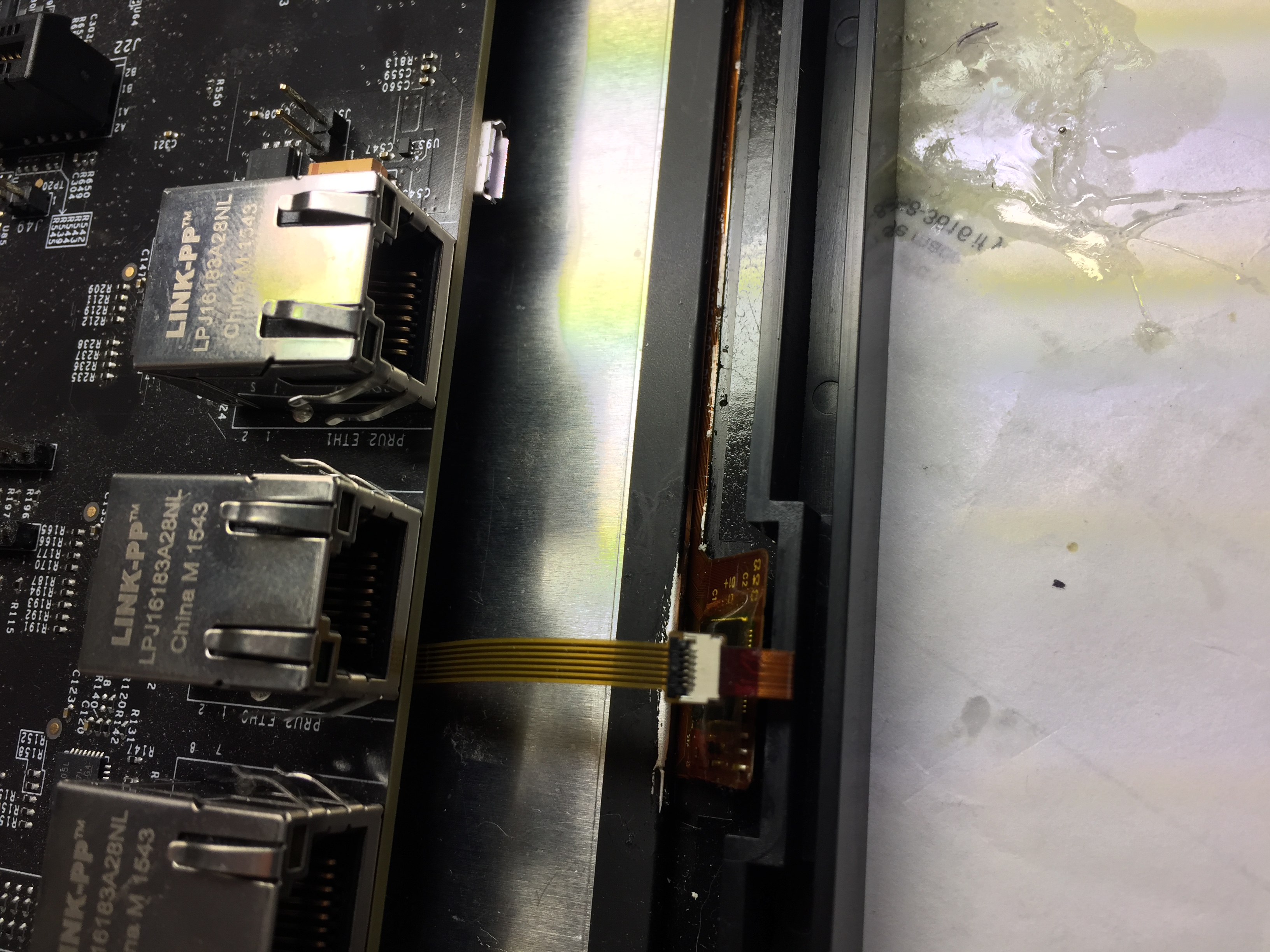

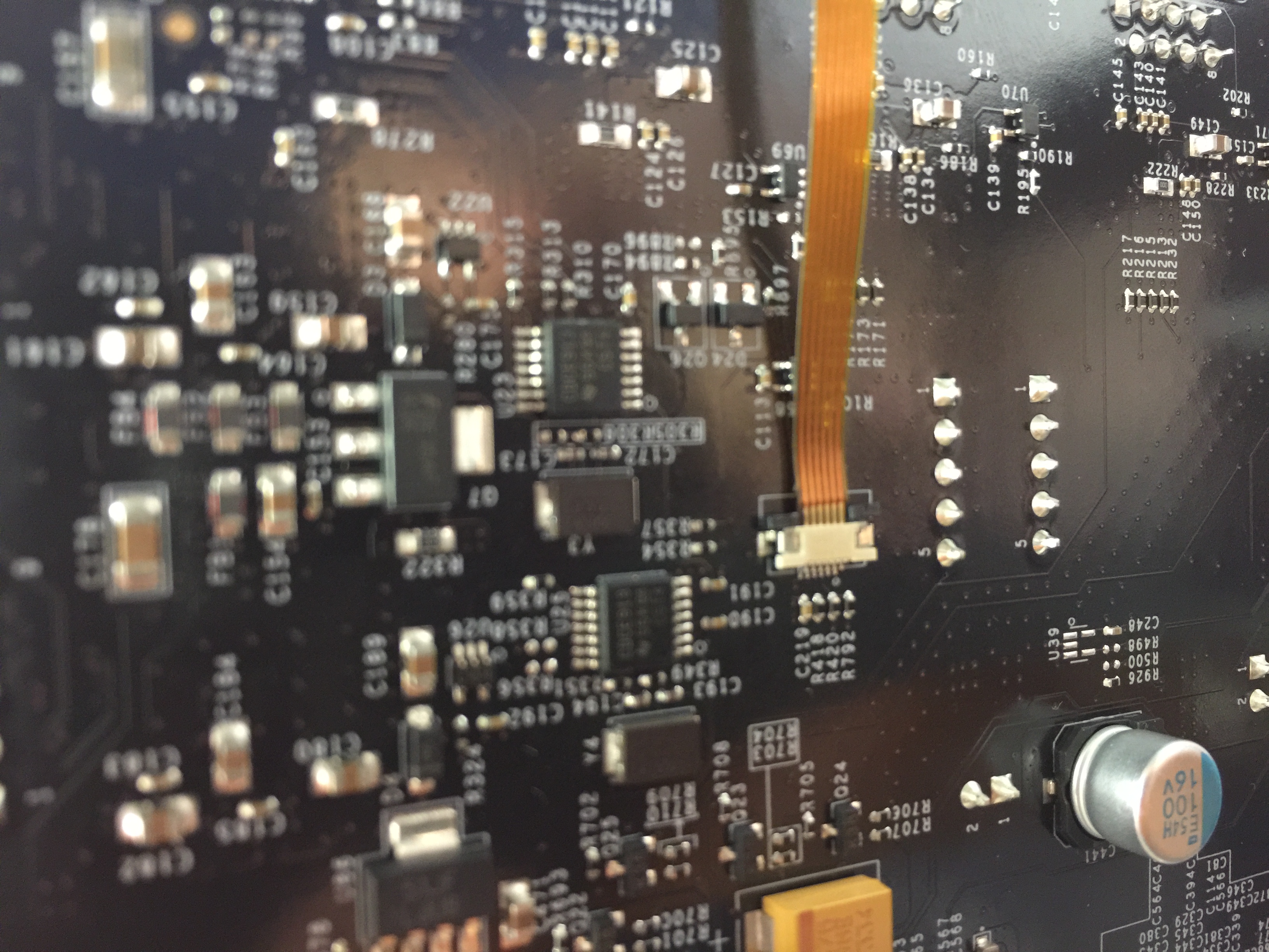

    I have already been through that document beforehand and at least on a few of times tried to reseat the ribbon cables already.  I would have liked to zoom in a little bit more but the resolution gets fuzzy in the referenced. I have attached three pics of my connections.
  • I don't see any attachments in your post. Is you LCD panel itself not getting detected or is it touch screen not working? Can you connect the mouse to the board and check the behavior.
    Most common problem people face is the small ribbon cable they reversed on both sides
    [1] On the IDK board side: The contacts need to “face upwards”, i.e. away from the board.
    [2] On the LCD panel side: with the white/black flap side of the connector pointing away from the space between the boards
  • Now that I reseated the ribbon cables again and I sent you the pics ... I know have "Please wait ..." on the display.  The orientation of the connectors had not changed but I reseated all of the connectors again and this time I had success.  I had always had a keyboard and mouse connected during my debugging here.
