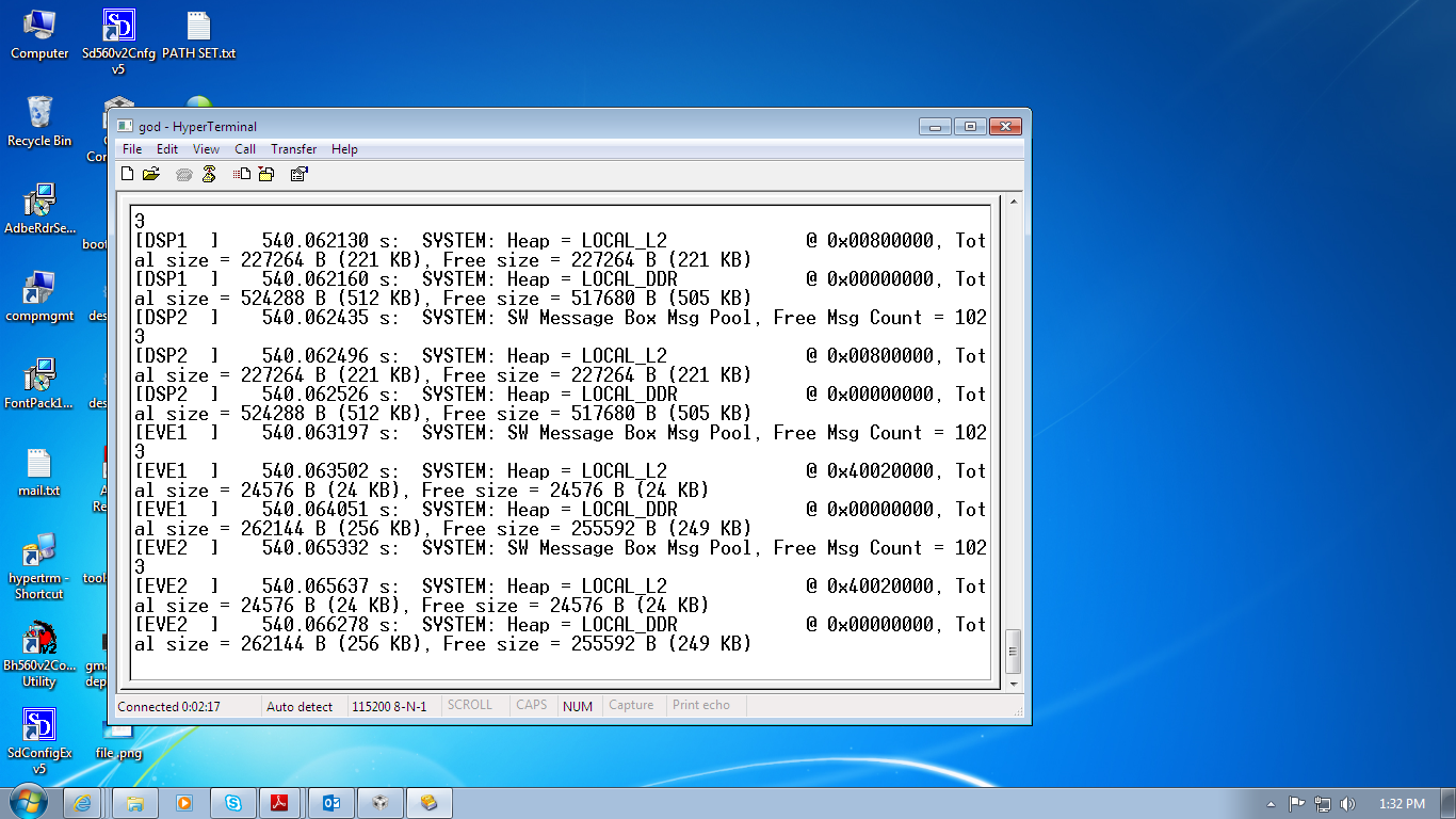

  • I have done above function, after that I choose particular function ,it shows like below image
  • This is the heap allocation status. Can you please save the whole log in a txt file and share the same?

    Your point of fail is the sensor initialisation. Do you have a OV10635 1280x720 Camera sensor attached to your EVM?
    [IPU1-0] 540.066918 s: CHAINS: Sensor create in progress !!!
    [IPU1-0] 540.067467 s: VIDEO_SENSOR: INST0 : I2C1 : I2C Addr = 0x30
    [IPU1-0] 541.297810 s: src/bsp_deviceI2c.c @ Line 765:
    [IPU1-0] 541.297901 s: I2C1: DEV 0x30: RD 0x300a ... ERROR !!!
    [IPU1-0] 541.297993 s: src/bsp_deviceI2c.c @ Line 836:
    [IPU1-0] 541.298084 s: I2C1: Error timeout 1230 ms!!!
    [IPU1-0] 541.298572 s: src/fvid2_drvMgr.c @ Line 725:
    [IPU1-0] 541.298664 s: Driver create failed!!
    [IPU1-0] 541.298755 s: src/fvid2_drvMgr.c @ Line 835:
    [IPU1-0] 541.298816 s: EBADARGS: NULL pointer!!
    [IPU1-0] 541.298877 s: CHAINS: Sensor create ... DONE !!!
    [IPU1-0] 541.298938 s: Assertion @ Line: 1512 in C:/VISION_SDK_02_12_00_00/v
    ision_sdk/examples/tda2xx/src/usecases/common/chains_common_vision.c: status ==
    SYSTEM_LINK_STATUS_SOK : failed !!!
    Piyali
