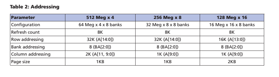

Here the DDR3 SDRAM used is MT41J128M16JT-125.As per the DDR3 datasheet the address configuration for this part no is A[13:0].
Why is Address bit A14 (DDR3 Pin no. T7) also connected ? In datasheet this Pin is mentioned as NC.

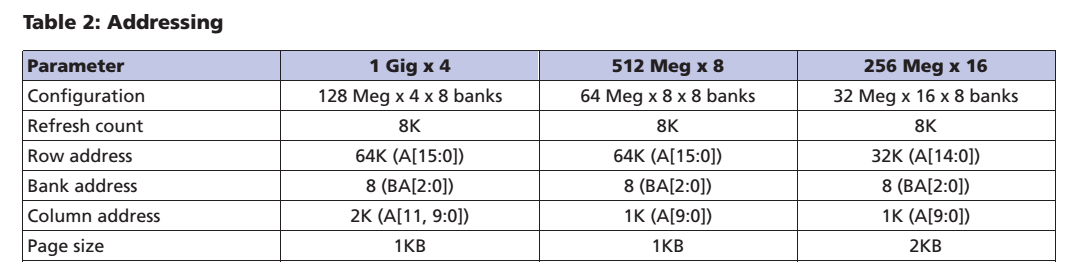

ii) We in our board, using MT41K256M16HA-125 DDR3 SDRAM has Addressing capability upto 15 bits A[14:0].
We are not connecting A15 address bit.
For DDR3 timing configuration, can both be compatible ?
