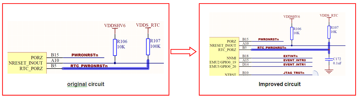

Hello, AM335x PMIC_POWER_EN can not  outputted High-level sometimes。
I saw "RTC_PWRONRSTn should be asserted for at least 1 ms to provide enough time for the internal RTC LDO output to
reach a valid level before RTC reset is released.".
My original circuit has not this 1ms delay, but I added  a 0.1uf  Decoupling Cap to VSS  for RTC_PWRONRSTn, the problem is still (The VDDS_RTC is 1.8V.),  What's the reason for that?
CAP_VDD_RTC connect 1uF Decoupling Cap to VSS
RTC_KALDO_EN  connect 10K resistor to VSS
PWRHOLD signal of TPS65910 connect  AM3352 PMIC_PWR_EN.
I do not use AM3352 On-chip RTC , use internal RTC LDO.
