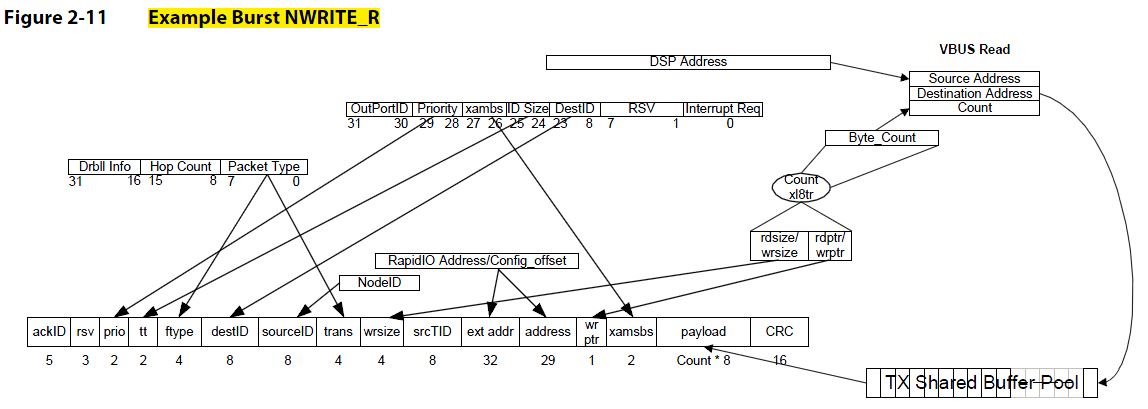

I have a customized board that contained FPGA and DSP. I want to send data from FPGA to DSP by SRIO.
I want to FPGA write data in DSP memory. After I studied " sprugw1b.pdf " I decided to use DIO and I run
" C:\ti\pdk_C6678_1_1_2_6\packages\ti\drv\exampleProjects\SRIO_LoopbackDioIsrexampleproject " examples.
According to " sprugw1b.pdf " page 63 if packet type is NREAD, NWRITE  ..., DSP is in DIO operation mode in
other words when FPGA send packets including SWRITE,NREAD, NWRITE, DSP received DIO packets.
Q 1:
Which field of header in FPGA is responsible  for DSP memory map address?
I studied " pg007.pdf " in page 168 describe the packet format as below.
Q 2:
Which field of frame determine the DSP memory address in the figure 2-11 in " sprugw1b.pdf " as below?
Q 3:
Why " WrPtr " is one byte?
Best Regards

    Q1/2:
    address + ext_addr + xamsbs form 63 bits address. Since SRIO requires double-word alignment and the SRIO addressing is 66 bits wide (or 34 or 50 depending on the size of the ext_addr filed), the address in the SRIO packet is a double word address. The missing 3 lsb and the unaligned bytes are coded in the wrsize+wrprt.
    Since the dsp addresses are 32 bits wide:
    address=dsp_address >> 3
    ext_addr=0
    xamsbs=0
    Q3: WrPtr is 1 bit wide (not 1 byte) and together with rdsize/wrsizee encode both the size and the "bytes lane" depending on the alignment
    (wrsize,wrptr)=encode(bytes_count, dsp_address & 0x7)
    For the encode() algorithm, look at SRIO specification.
    If your playload destination address in not double-word aligned and is longer then 7 bytes, the transfer must be broken in more packets:
    1. Leading unaligned bytes, len=dsp_address & 0x7, to align next transfers
    2. one or more 256 bytes fragments, double-word aligned
    3. Trailing unaligned bytes (up to 7 bytes)

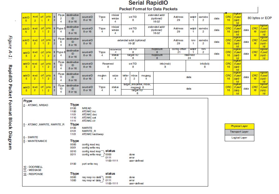

  • Hi
    Thank you so much, Alberto.
    Please, guide me I understand you correctly.
    Ftype 5 (NWRITE):
    I should accomplish this steps for writing in DSP:
    1) I should shift DSP address 3 bits right and write the address in the address field of the header.
    2) I should set "ext_addr" and "xamsbs" zero.
    3) I should set WrPtr and WrSize according to 3 remain lsb bits and encoding algorythms.
    Q 1:
    I studied the "sprugw1b.pdf " and there wasn't anything about encoding algorythm!!!
    Please introduce me a reference that explained encode algorithm or how can I set "WrPtr" and "WrSize" fields?
    Ftype 6(SWRITE):
    There isn't "WrPtr" and "WrSize" in the header fields.
    Q 2:
    Is the writing steps same as Ftype5?
    If the answer is yes what should I do about "WrPtr" and "WrSize" fields?
    If the answer is NO, guide me please.

  • Dariush,
    The details of forming RapidIO packet header is not described in Keystone Serial RapdioIO user guide sprugw1b as the SRIO Load/Store unit (LSU) in Keystone provides the mechanism to abstract and auto fill all the header fields of the RapidIO packet. There are 8 LSU in total, and each LSU has its own set of 7 registers. LSU_Reg0-4 is used to store “Control” information, LSU_reg5-6 for “Command” and Status information. You may check with your FPGA vendor to see if there is similar mechanism/module for structuring RapidIO packet header.
    RapidIO in Keystone is RapidIO Interconnect Specification REV2.2 compliant. You may also look into the document - RapidIO™ Interconnect Specification, Part 1: Input/Output Logical, Chapter 4 Packet Format Descriptions, www.rapidio.org/.../, for DirectIO packet header field description.
    wdptr: Word pointer, used in conjunction with the data size (rdsize and wrsize) fields—see Table 4-3, Table 4-4 and Section 3.5.
    rdsize: Data size for read transactions, used in conjunction with the word pointer (wdptr) bit—see Table 4-3 and Section 3.5.
    wrsize: Write data size for sub-double-word transactions, used in conjunction with the word pointer (wdptr) bit—see Table 4-4 and Section 3.5.
    In general, the steps you listed for Ftype 5 is correct. For "WrPtr" and "WrSize" fields setting, refer to above description.
    For Ftype 6, there is no size or transaction ID fields, so basically you just need step 1 and 2, please refer to 4.1.8 Type 6 Packet Format (Streaming-Write Class) in RapidIO spec.
    Garrett
