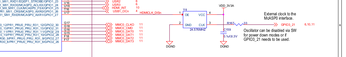

    You cannot generate a 44.1kHz bit clock from the 24MHz clock source available on AM335x. You will need an external clock source to do this.
  • Hi Biser,
    Thanks for reply. Can you please verify pin muxing. I will discuss and revert you regarding the clock source.
    Deep
  • One more concern Biser, How can the clock be generated externally
  • Regarding pinmuxing, I have asked the software team to comment.
    Regarding the clock source, an external clock generator is necessary to provide a master clock that can be divided down by the McASP to the 44.1kHz bit clock you require. The issue here is that the internal master clock is fixed to 24MHz (main oscillator clock), and the McASP divider is not fractional. 24MHz / 44.1kHz = 544.217 If you use a divider value of 544 you will get 24MHz /544 = 44.117kHz. You can check, this may be close enough for your requirements.
  • Hi Biser...
    LRCLK is 44.1 KHz not the bit clock.
  • So what bit clock do you need?
  • As Bit Clk= SampleRate * Channels * BitsPerSample
    for 44.1 kHz, 16-bits stereo audio, the min BCLK is 1.4112 MHz. So this Bit clock is our requirement
  • OK, this is a divide by 17 from 24MHz, so you won't need an external clock.

  • Deep,
    Regarding BCLK/ACLKX, what frequency you need there? 44.1KHz is supported by default in McASP driver:
    processors.wiki.ti.com/.../AM335x_Audio_Driver's_Guide
    Multiple sample rates support (8KHz, 16KHz, 22.05KHz, 32KHz, 44.1KHz, 48KHz, 64KHz, 88.2KHz and 96KHz) for both capture and playback.
    Regarding LRCLK clock, on which McASP pin exactly you connect this codec pin? Please provide more info regarding codec LRCLK signal.

    BCLK is supplied by mcasp0_aclkx pin correct? So you need to output 1.411MHz (1411KHz) on this pin? Which is the clock source of your mcasp0_aclkx pin (AUX_CLK or AHCLKX)? See AM335x TRM, section 22.3.5.1 Transmit Clock
    If you are not sure regarding the source, provide me the values of the below McASPo registers:
    AHCLKXCTL
    ACLKXCTL
    deep ter said:
    LRCK=44.1KHz
    Do you connect Dirana3 codec LRCK pin to mcasp0_fsx pin? Please provide more info regarding LRCK signal.
    Pavel

    Yes Pavel,
    BCLK is supplied by mcasp0_aclkx pin. Also mcasp0_fsx is connected to LRCK pin of DiRANA3 .
    I need to output 1.411MHz (1411KHz) on this pin as I am using a stereo channel with 44.1KHz sampling frequency.

    This means I am giving AUX_CLK as source of aclkx_pin. Please correct me if i am wrong.
    I checked the device parameters added in the link e2e.ti.com/.../456475.
    .tx_dma_offset = 0x46800000,
    .rx_dma_offset = 0x46800000,
    .op_mode = DAVINCI_MCASP_IIS_MODE,
    .num_serializer = ARRAY_SIZE(ti811x_iis_serializer_direction_mcasp2),---------------------------------------MCASP2
    .tdm_slots = 2,
    .serial_dir = ti811x_iis_serializer_direction_mcasp2,
    .asp_chan_q = EVENTQ_2,
    .version = MCASP_VERSION_2,
    .txnumevt = 1,
    .rxnumevt = 1,
    /* McASP2_AHCLKX out to feed CODEC CLK*/
    .clk_input_pin = MCASP_AHCLKX_IN,
    But in am335x-beaglebone.dts I was unable to find how to put MCASP_AHCLKX_IN as i/p.
    I will share you the values of AHCLKXCTL and ACLKXCTL in some time
    Deep

    Do you have any clock output on mcasp0_aclkx pin?
    mcasp0_aclkx frequency depends on:
    1. MCASP0_FCLK (aux_clk) frequency - please provide me what is the frequency of aux_clk
    2. McASP0 registers PFUNC, PDIR, ACLKXCTL and AHCLKXCTL - please provide me what values you have in these registers
    Pavel

  • Hi Pavel,
    I was not able to get the aux clock value.
    I was going through the BBB schematic and I found this:
    So  I need to configure GPIO3_21 as a clock  and this clock would be input to  MCASP0_AHCLKX as shown in the schematics:
    If you are going to use aux_clk as source for aclkx, you do not need ahclkx. Using aux_clk is the "internal" case explained in AM335x TRM, section 22.3.5 Clock and Frame Sync Generators, while using ahclkx is the "mixed" case. You should use one or another, not both at the same time.

  • Hi Pavel,
    I went through the BBB schematic..I have used AHCLKX_IN as an input.
    I am now getting clocks on ACLKX and AFSX pins and I am able to .wav file through aplay.
    Now my flow is like this:
    24.576MHz(From BBB Crystal) --> AHCLKX_IN--> ACLKXCTL[4:0]--> ACLKX--> Bit Clock---> Audio Codec
    The frequency on ACLKX pin = 1.446 MHz (instead of 1.411 MHz)
    AFSX pin = 45.19KHz ( instead of 44.1 KHz)
    Due to this I am getting a lot of noise along with the audio. Do you have any clue on this?

    See also "Interfacing DRA7xx Audio to Analog Codecs" applicatio note, 5.3 Example: McASP3 in I2S Mode, it is very similar to your case
  • Hi Pavel,
    Thanks for your reply.
    With setting of system-clock-frequency = <24576000>, McASP is also taking it as sysclk frequency. Checked by applying the following logs:

    I can measure the signals at ACLKX pin..but how to validate the AXR0 signal
    The AXR0 pin is used for audio data transmit. You can check AM335x datasheet and TRM for what to expect on that pin. See the below figures:
    AM335x datasheet, Figure 7-87. McASP Output Timing
    AM335x TRM, Figure 22-10. Inter-Integrated Sound (I2S) Format
    You can also run audio playback test on AM335x EVM or StarterKit and monitor the aclkx/afsx/axr0 pins to see what they have when system runs fine.
    You can also run audio playback test on AM335x BeagleBoneBlack HDMI and monitor the aclkx/afsx/axr0 pins to see what they have when system runs fine.
    deep ter said:
    I am able to hear the audio from the codec...but along with the audio a lot of noise is there.
    Check if some error (like buffer underflow/overflow) is logged in McASP registers when noise occur. Check also system resources (CPU load, memory usage) are available for the audio application (system is NOT running out of resources) . See if the below pointers will be in help:
  • Hi Pavel,
    Please check the logs attached .. Although I have enabled CONFIG_DYNAMIC_DEBUG.. i did not get any logs.. I had attached my logs in the previous message.
    Deep
  • deep ter said:
    Yes the values at ACLKX pin are coming fine. Please check the ACLKX waveform.
    deep ter said:
     ---for sampling rate 48Khz
    Looks correct. You have 24.576MHz source clock divided by 16 to produce 1.536MHz bit clock for 48KHz sample rate.This is aligned with the equation for 16-bit stereo (2 channels) audio:
    bclk = channels * SampleRate * BitsPerSample = 2 * 48K * 16
    Can you confirm you have ACLKXCTL[4:0] CLKXDIV = 0x0F (div by 16) in this case?

  • Hi Pavel,
    On your previous query ,
    "Can you confirm you have ACLKXCTL[4:0] CLKXDIV = 0x0F (div by 16) in this case? "
    Yes the divider in the case of 48khz is 16.
    Register 0x480380B0 value of ACLKXCTL af (Hence the diver is 16)
    Now if I am changing the clock source to AHCLKX_IN from external 24.576MHz oscillator to AUX_CLK .. then this will be my device tree changes.
    sound_master:simple-audio-card,cpu {
    sound-dai = <&mcasp0>;
    system-clock-frequency = <sys_clkin_ck>; -------changed from 24.576MHz to sys_clk_in

    In AM335x BBB we have:
    am335x-boneblack.dts
    clk_mcasp0_fixed: clk_mcasp0_fixed {
            #clock-cells = <0>;
            compatible = "fixed-clock";
            clock-frequency = <24576000>;
        clk_mcasp0: clk_mcasp0 {
            #clock-cells = <0>;
            compatible = "gpio-gate-clock";
            clocks = <&clk_mcasp0_fixed>;
            enable-gpios = <&gpio1 27 0>; /* BeagleBone Black Clk enable on GPIO1_27 */
    dailink0_master: simple-audio-card,cpu {
                clocks = <&clk_mcasp0>;
            simple-audio-card,codec {
                sound-dai = <&tda19988>;
    Here we provide 24.576MHz to McASP0 AHCLKX input, thus we can only produce 48KHz, 96KHz and 192KHz sample rate for TDA19988 HDMI audio.

    2) Using the external clock I used the same settings given in am335x-boneblack.dts
    #clock-cells = <0>;
    #clock-cells = <0>;
    sound {
    compatible = "simple-audio-card";
    simple-audio-card,name = "TI BeagleBone Black";
    simple-audio-card,format = "i2s";
    simple-audio-card,bitclock-master = <&sound_master>;
    simple-audio-card,frame-master = <&sound_master>;
    sound-dai = <&saf775x>;
    In this case clocks came but with the same noise and frequency.

    This is working fine from the processor side. The issue was from the Dirana3 side. The format which we need to set was asynchronous Philips mode input instead of 16bit LE . In this mode the Dirana3 can take input of any frequency word clock (32Khz,48Khz) and it can use its Sample rate convertor to make it 44.1Khz
    Thank you for all your support. I will come back to you when i start with the capturing of data
