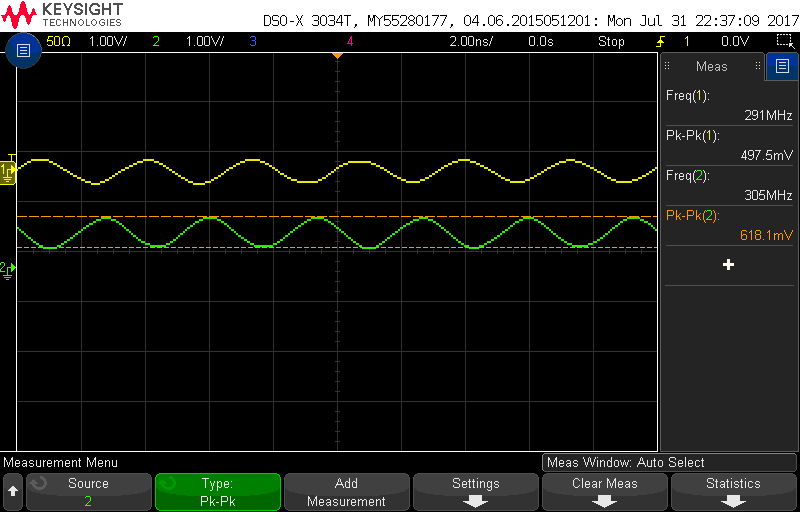

  •   Hi Biser,
    Today we have tried to probe the signals , we have probe the DQS/DQSn (Strobe signal), CKE (Clock Enable), WE (Write Enable) and ODT (On-die termination) signals. While executing write command, WE assert low, CKE enable is high and ODT asserts high, but there is no DQS/DQSn signals from AM3352.
    Please check the attached waveform for your reference and suggest.
    Daljeet
  • This is not normal. What is running on the AM335x when you are taking these screenshots? Are you sure the EMIF is properly initialized? Do you see this on a single board or across multiple boards?

  •   Hi Biser,
    I have tried to probe the CK and CK#, it seems that we are getting the 300MHz clock at CK# and not in CK. Please suggest.
  • I already pointed out in my initial replies that you have severe design/manufacturing issues. If what you are measuring is really what is shown on those scope screenshots, this board will never work. I have never seen such DDR behavior. On my part I cannot help further with this issue.

  •  Hi Siva,
    Today we have successfully get the differential clock of 300 MHz at CK/CK# and validated all the control signals which are (WE#, CS#, RESET#, RAS, CAS, CKE) which are asserted and de-asserted while AM3352 Initialisation.
    But we are not getting the DQS/DQSn strobe clock while Data latch. As a next step we need to find the root cause for the same.
    Please check the attached Differential clock for your reference and let me know your valuable suggestions.
    Daljeet
