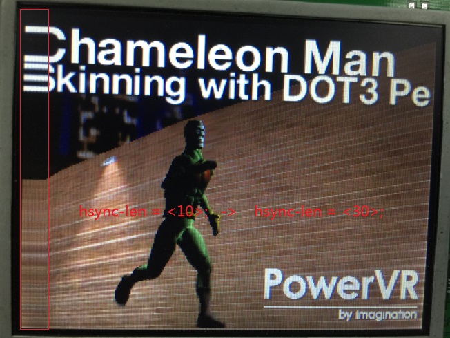

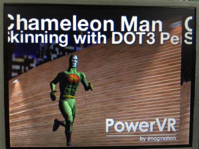

Now.Here is the strange part.
After the u-boot is done.And when kernel starts up.I can see that the kernel displays image slightly moved to the left. (  kernel worked well when the lcd driver is not implemented in the u-boot.)
i started a SGX demo application to show you what it would look like.Here:

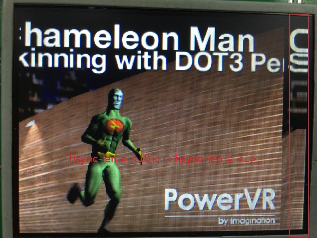

So.To my experience i started to change hsw or hbp or hfp to see if i can get it right.But turned out that none of the parameter really solved the problem.
Here's what i did.
1.hsync-len = <10>;     ->      hsync-len = <1>;
As you can see in the photo below.There is this strange area of pixel (a vertical column in the red square i marked).The pixels seems to be repeating themselves.
2.hsync-len = <10>;   ->    hsync-len = <30>;
As you can see.I managed to align correct the right column.But the strange pixel area persists.

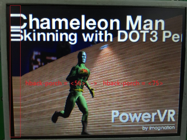

3.hback-porch = <56>;  ->   hback-porch = <75>
basically the same as the last experiment.I managed to align correct the right column.But the strange pixel area persists.Only this time it's the hbp i chanegd.
4.hfp don't affect the display however i changed it.

a.no matter how i modified hfp/hbp/hsw. Not to mention vfp/vbp/vsw. the phenomenon exists.
b.in the lcd driver of u-boot. the source of clock for the lcd driver doesn't matter. Be it display PLL.Or pheripheral pll. Or even core pll.
c.i even tried to cut out the lcd driver of uboot piece by piece. To remove pieces of code to find out exactly which setting caused the kernel to behave strangely.But there's no success.As soon as the code reaches RasterEnable(SOC_LCDC_0_REGS); Things went wrong.
Please advise what is should do?
