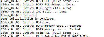

Next I tried to program the SPI flash via the C6678 DSP as described in manual. I used CCS and C:\ti\ccsv5\ccs_base\emulation\boards\evmc6678l\gel\evm6678l.gel as our board's .gel file to connect to our board but the .gel file did not match to our board, DDR3 test failed and the console gave next output:
At test time the DSP reads different values that it wrote before.
