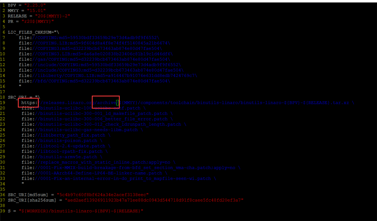

    Ramprasad,
    I modify sources/meta-linaro/meta-linaro-toolchain/recipes-devtools/binutils/binutils-linaro-2.25.inc like that:
    releases.linaro.org/.../binutils-linaro-${BPV}-${RELEASE}.tar.xz \  to
    It is ok!
