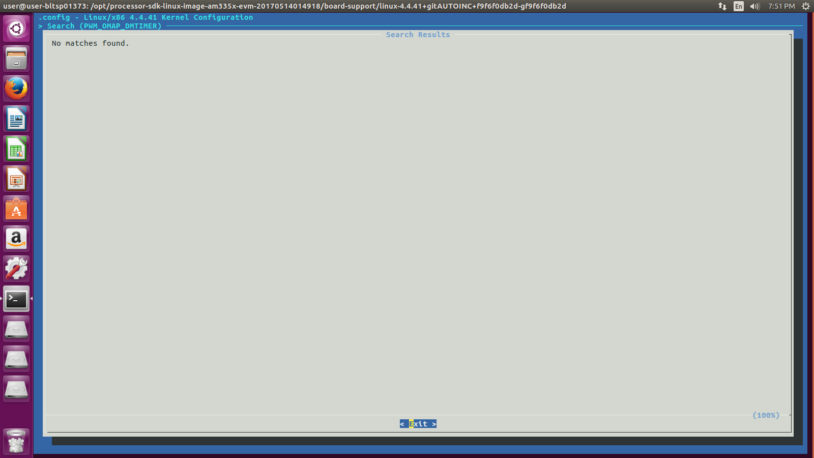

    From the first link, the below node is mentioned to use timer7 as pwm.
    pwm7: dmtimer-pwm {
    compatible = "ti,omap-dmtimer-pwm";
    ti,timers = <&timer7>;
    #pwm-cells = <3>;
    From the above I did not understand where is "omap-dmtimer-pwm" driver in the SDK?. Blindly I have tried including the above node in my dts. But under /sys/class/pwm nothing got created.
    pwm7: dmtimer-pwm {
    #pwm-cells = <3>;
    This dmtimer pwm driver is available from PSDK v4.00 onwards (kernel 4.9.28). I would suggest you to switch to the latest PSDK v4.01 (kernel 4.9.41) or at least to PSDK v4.00 to be able to use that driver:
    {PSDK4.x}/board-support/linux-4.9.x/drivers/pwm/pwm-omap-dmtimer.c
    You should enable that driver through the menuconfig (CONFIG_PWM_OMAP_DMTIMER=y) as it is disabled by default in the am335x evm config file:
    {PSDK4.x}/board-support/linux-4.9.x/arch/arm/configs/tisdk_am335x-evm_defconfig
    Pavel

    arch/arm/configs/tisdk_am335x-evm_defconfig - # CONFIG_PWM_OMAP_DMTIMER is not set
    You should enable PWM_OMAP_DMTIMER driver through the menuconfig feature
    In my case, through menuconfig I don't see PWM_OMAP_DMTIMER option (you can refer the below screen shot)
    But still I have already unset in the arch/arm/configs/tisdk_am335x-evm_defconfig file.
    Once you port it successful, you will be able to see it.

  • Hi Pavel,
    I am able to compile it successfully. I will enable backlight in my dts and let you know the results.
  • Hi Pavel,
    After compiling th kernel with pwm7 and backlight nodes, below are the results,
    root@am335x-evm:~# dmesg | grep timer
    [    0.000000] OMAP clockevent source: timer2 at 24000000 Hz
    [    0.000046] clocksource: timer1: mask: 0xffffffff max_cycles: 0xffffffff, max_idle_ns: 79635851949 ns
    [    0.000059] OMAP clocksource: timer1 at 24000000 Hz
    [    0.249080] clocksource: Switched to clocksource timer1
    [    0.267703] omap_timer 4804a000.timer: could not find pctldev for node /ocp/l4_wkup@44c00000/scm@210000/pinmux@800/timer7_pins_dee
    [    0.290889] /backlight: could not get #pwm-cells for /dmtimer-pwm@7
    root@am335x-evm:~# dmesg | grep pwm
    [    0.290557] pwm-backlight backlight: GPIO lookup for consumer enable
    [    0.290582] pwm-backlight backlight: using device tree for GPIO lookup
    [    0.290910] pwm-backlight backlight: unable to request PWM
    [    0.291128] pwm-backlight: probe of backlight failed with error -22
