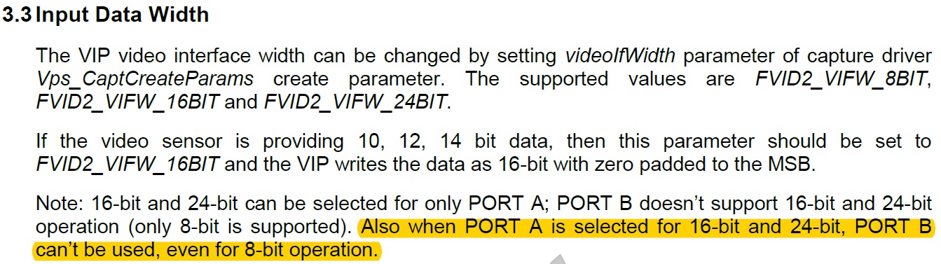

Hi all,
My code base is PROCESSOR_SDK_VISION  03_01_00_00 and use custom board.
I found the "Video Driver Porting Guide for TDA2xx, TDA2Ex and TDA3xx" from following link.
/cfs-file/__key/communityserver-discussions-components-files/791/2045.Video_5F00_Driver_5F00_Porting_5F00_Guide.pdf
The chapter 3.3 input data width described port B can not be used when port A selected for 16bit or 24bit. Does this limitation both occur on RTOS and Linux? Any workaround can resolve this issue?
Thanks in advance.
B.R.
OC
