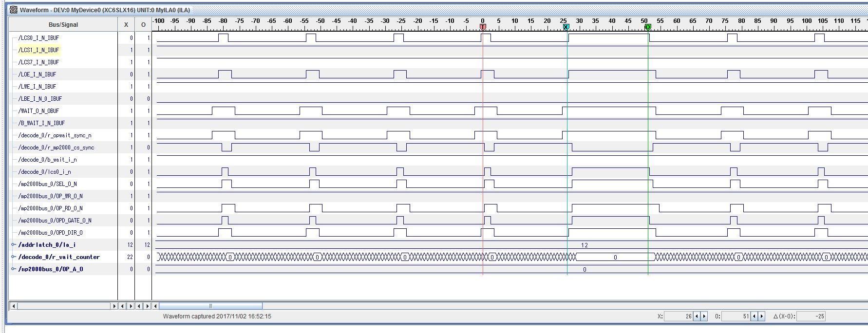

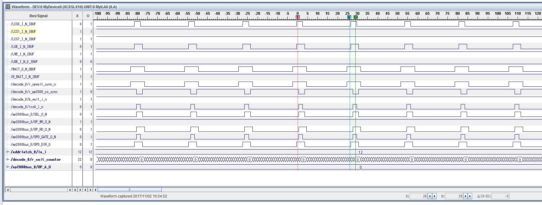

Depending on the number of executions of the code, GPMC read access is affected.
GPMC register is set as follows.
GPMC_CONFIG1_i 0x60 0x00601211
GPMC_CONFIG2_i 0x64 0x00090902
GPMC_CONFIG3_i 0x68 0x00010100
GPMC_CONFIG4_i 0x6C 0x06030903
GPMC_CONFIG5_i 0x70 0x00090A0A
GPMC_CONFIG6_i 0x74 0x86020281
GPMC_CONFIG7_i 0x78 0x00000F42
During GPMC read access,
When cortexA15 executes more than 40 instructions, 170ns delay occurs with GPMC access.
Why does this delay occur?
Please tell me how to solve the delay.

no instructions between gpmc reads -> no delay

Added 20 lines of instructions between gpmc reads -> no delay between accesses of added code

Added 40 lines of instructions between gpmc reads -> 170ns delay between accesses of added code

  • Hi Shin-san,
    Thank you for quick reply.
    If there is a lot of single access to FPGA and they want to realize as fast access as possible, which of the following should be better for GPMC?
    1. Set as cache area
    2. Set as non-cacheable area
    In the case of Rahul-san's answer NOR flash setting, it seems that it is set as non-cache and strongly-ordered memory area.
    The wiki site of your introduction has the following description.
    · Set as cache area
    · Using multiple load instructions
    Shigehiro Tsuda
  • Tsuda-san,
    If the FPGA memory space accessible by GPMC can be only changed by AM5728 (i.e. the data doesn't change by FPGA activity), the GPMC memory space for FPGA should be set to casheable. Otherwise, it should be set to non-casheable.
