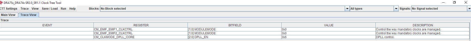

  • Hello John,
    Not the EMIF expert, but fired up the Clock Tree Tool and tried disabling EMIF there. Looks like these registers do the trick to cut the clocks for EMIFs.
    Can they try these CLKCTRL register too?
