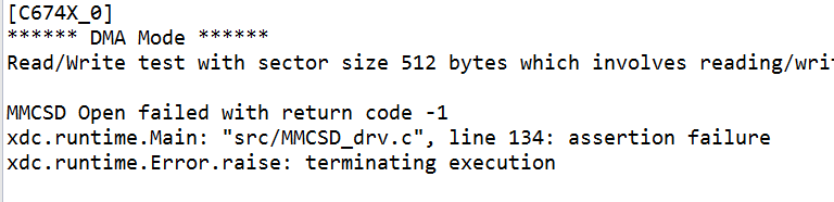

  • Hi Ilan R,
              I'm trying to use the eMMC driver, and I use  a 16Gb eMMC device (MTFC16GAKAECN-2M),
              I follow the modifications as you did in the main_emmc.c file, while taking no changes with the MMCSD_v0.c file.
             I find the MMCSD_lcdkOMAPL138_c674xTestProject project, which is a non-DMA with polling mode test project, can work normally.
             But the MMCSD_lcdkOMAPL138_DMA_c674xTestProject project can not work normally:
           and then I modified the MMCSD_v0.c file as you did, nothing changes.
           Have you tried the driver with EDMA or with Interrupt?
           B.R.
    Frank

  • Hi Frank
    you can use the following steps to build the DMA project:
    • import project: MMCSD_FatfsConsole_lcdkOMAPL138_DMA_c674xExampleProject
    • add files main_emmc.c , MMCSD_log.c , MMCSD_log .h that can be found at  \pdk_omapl138_1_0_2\packages\ti\drv\mmcsd\test\src
    • in main_emmc.c  change all SOC_OMAPL137 to SOC_OMAPL138
    • delete main.c
    • change file\pdk_omapl138_1_0_2\packages\ti\drv\mmcsd\src\v0\ MMCSD_v0.c  according to the instruction below (I had problem to upload the file)
    change line 159 to:
    #define EMMC_FIX
    /** \brief MMC Argument Register value for OCR command. */
    #ifdef EMMC_FIX
    #define MMCSD_OCR_AGRHL_REG_VAL (0x40FF8080)
    #else
    #define MMCSD_OCR_AGRHL_REG_VAL (0x00FF8000)
    #endif
    and lines 1753 to:
    #ifdef EMMC_FIX
    cmdObj.cmd.xferType = MMCSD_DIR_READ;
    #else
    cmdObj.cmd.xferType = MMCSD_DIR_DONTCARE;
    #endif
    cmdObj.cmd.lineChr = MMCSD_LINECHR_PUSHPULL;
    transaction.arg = object->rca << 16U;
    transaction.blockCount = 1U;
    transaction.blockSize = 512U;
    #ifdef EMMC_FIX
    transaction.checkStatus = MMCSD_EVENT_EOFCMD | MMCSD_EVENT_READ;
    transaction.flags = MMCSD_CMDRSP_READ | MMCSD_CMDRSP_DATA;
    #else
    transaction.checkStatus = MMCSD_EVENT_EOFCMD | MMCSD_EVENT_ERROR;
    transaction.flags = MMCSD_CMDRSP_READ | MMCSD_CMDRSP_WRITE;
    #endif
    • build the mmcsd driver according to ti instruction
    this test work for me but I had some other problems with the driver after trying to integrate it in my project
    •  if I try to read from memory after open, the read stuck after board power up (turning power off and on) but on the second run from debug it run correctly. this means that after programming the unit and switch it on, it will stuck. the work around I currently use is to write dummy data to the emmc to an address space not in use and then use the device normally.
    • I do not understand why can I read and write data from address 0, If I use address less then 0x4000 the read and write are unstable - it can work for 10 times and then fail
    • I have also have another board that work on debug but not on power up (even after the work around of writing and then reading.
    • I add also delay between write operation (I had some problem when reading write command one after the other without delay)
    It seems to be some problem with the Edma or memory that do not work correctly,
    In my project   I use the starterWare drivers (EDMA and other), as I didn't find support for EMMC in starterWare I tried this driver from the new SDK, but lately I found out that there is support for the emmc driver in starterWare sourceforge site I am planing to check it too and to find out if it work correctly.
    Sahin can you please let us know if you have any solution for the EMMC driver?
    What is the address space that I can use for read and write?
    why does after power up the read operation stuck (on EDMA transfer) after driver open?
    the changes I made in the driver code were -
    • argument for CMD1 was not correct in the original driver (the memory is block address and not byte address)
    • CMD 8 read CSD_EXT register using DMA and memory data lines so I change the transfer to be as read command

  • Hi Sahin,
          Thank you so much for reply.
          I follow your guide and rebuild the emmc driver (add #define ENABLE_EMMC in the MMCSD_v0.c ), and then run the nonDMA version test program, the program stuck at the emmc_write() function.
          Could you provide me a        DMA version project with Interrupt enabled that suit for C6748+eMMC, which can work normally?
          Could you provide me a nonDMA version project with Interrupt enabled that suit for C6748+eMMC, which can work normally? As I metioned, I found the nonDMA version have to use "delay" between emmc_write/emmc_read, which means the app cannot be used freely.
          We've stuck at this problem for several month. And if the emmc cannot be used, we have to give up C6748 and move to other platforms. Really need TI's help!
          For the block size of the MTFC16GAKAECN-2M I use, it's 512.
          For the boot mode, do you mean that. If the dsp BOOT MODE = 00010000  which means NAND16 boot, the DMA driver cannot work normally, while the if the Boot mode=00001110  which means  NAND8 boot, the driver can work normally? I use  BOOT MODE = 0001 1100, which is emmc boot, can the DMA driver work normally?
    Thank you so much!
    Frank
