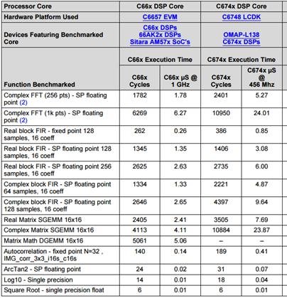

hi TI professors,
    I'm realizing 4096 points FFT in C6678 single core. I look the DSP performance consume provided by TI Co. The 1K points single  float FFT use time 6269 cycles, But I test 1K points about 77804 cycles and 4096 points about 384008 cycles. I  use the DSPF_sp_fftSPxSP() function to realize the FFT.
