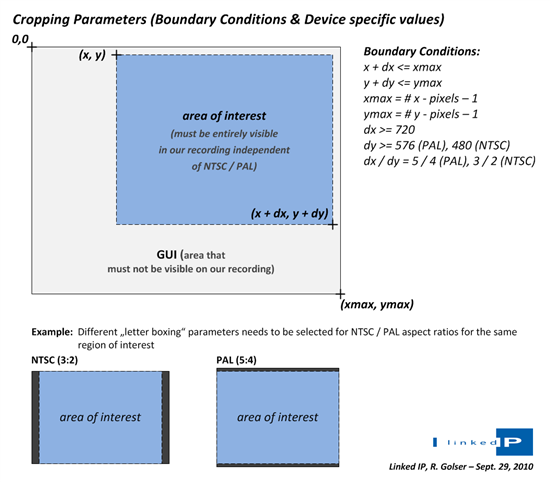

We are currently working on the VPFEs capability to crop images out of the incoming video and have the requirement for letter boxing (for example for NTSC /PAL output but of course also for other resolutions) for the outgoing stream that will be compressed by the Video Coprozessor. But, we did not find any information how to implement this - is this possible using the black clamp configuration?

    Input Format Requirement:
    Resolution: e.g. 1280x1024@60Hz
    Cropping Region: e.g. x=335, y =15, dx=900, dy=720 (but: arbitrary cropping regions required – that means that video input and output aspect ratios may be different)
    Chroma Subsampling: 4:2:2, YCbCr
    Output Format Requirement:
    Resolution: 720x576@24Hz or 720x480@24Hz (letter boxing in x- and y-direction in the case that video input and output aspect ratios are different)
    Letter Boxing in Region: e.g. x=335, y =15, dx=900, dy=720
    Chroma Subsampling: YUV, 4:2:0
    CODEC: we are using the MPEG-2 CODEC with Main Level, Main Profile

  • Dear Anshuman,
    thank you for your response. This describes the implementation for vertical letter boxing (see case 1). Thats nice!
    Please see my picture below that describes the situation for horizontal as well as for vertical letter boxing:
    In case of vertical letter boxing, shown in representation 1, we can use your implementation.
    In case of horizontal letter boxing, shown in representation 2, we need to adjust the starting address for the resizer to fulfill the 32 Byte alignment. For chromaticity information that means a multiple of 64 pixels, assumed that the buffer start address X is fixed.
    Thus we need to use representation 3 to describe the real behavior.
    Due to the black segments at the beginning and at the end of each line the resizer output area is not a continuous memory area anymore. Where can we adjust this necessary offset after each line within the resizer module?
    Basically, you need to change the line offset for the data. This can be changed in fmt.fmt.pix.bytesperline before the VIDIOC_S_FMT ioctl in capture.c
    So for your case, fmt.fmt.pix.width = 640 while fmt.fmt.pix.bytesperline can be 704 or some other number based on the calculation.
