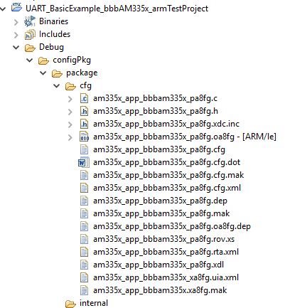

Now that I have the LED blink demo running with UIA, I am trying to get UIA running on my actual project and am running into a lot of build issues.  My guess is it has to do with the version of UIA I am using?
I am running with GNU compiler 4.9.3 and the following products selected:
Let me know if you want me to open a different thread for this or keep it here.
  • Can you please provide the build log from your project. This will help us understand if the reason for the build failure is your UIA version.
    Rahul

  • Hi Alexander,
    There are three reasons (that I know of) why you are getting this.
    1. You don't have any UIA Loggers in your application. This is not your problem, but you can confirm by opening up ROV on a loaded device and making sure LoggerStopMode is present.
    2. You are not using the CCS debug session to load the image. It does not sound like this is the case either.
    3. You are missing the <CCS build configuration>/configPkg/package/cfg/<.cfg name>_<target>.rta.xml and/or <CCS build configuration>/configPkg/package/cfg/<.cfg name>_<target>.uia.xml files.
    For example (different device, but the same idea) C:\workspace\F28379D\stairstepStopMode_EK_TM4C1294XL_TI_TivaTM4C1294NCPDT\Debug\configPkg\package\cfg\stairstep_pem4f.rta.xml.
    These files get built as part of the build. They are found automatically by System Analyzer as long as they are underneath the .out location or in the same directory as the .out.
    I'm hoping it's number 3.
    Todd
  • Sorry - it looks like I have all those items accounted for.
    You should be able to easily reproduce this issue as it is using an out of the box example with Processor SDK  4_01_00_06 and UIA 2.0.6.52.
  • Unfortunately I don't have that board. I need to look around and try and find one. Which CCS are you using?
  • I am using Version: 7.4.0.00015
