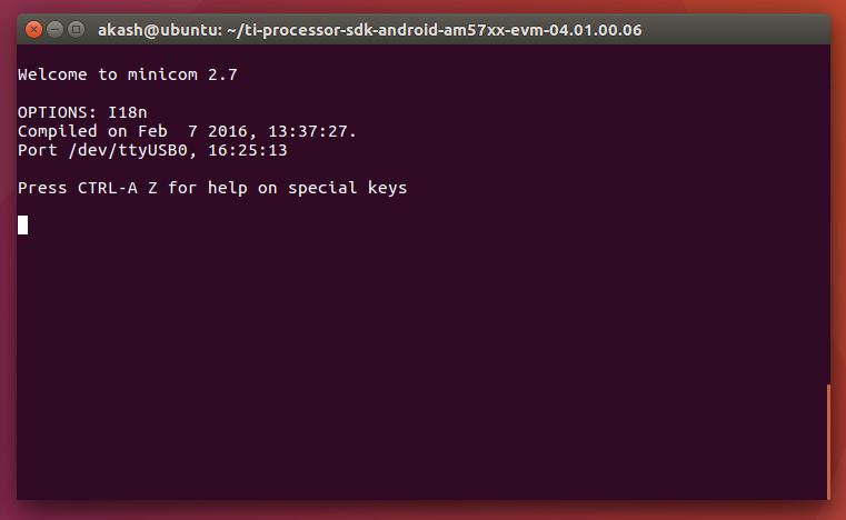

Hi team,
I am working with the AM572x EVM, TMDSEVM572X, and I am going through the Getting Started Guide here: http://processors.wiki.ti.com/index.php/Processor_SDK_Android_Getting_Started_Guide
I've following steps 1-4 and working on step 5 to run the setup script. After running the setup script, I power cycle the board and nothing seems to happen. The screen turns on momentarily and then turns off and below is what my terminal looks like. How can I get past this step to boot Android?

  • Hello Akash,
    Just to double check: How are you power cycling the board?
    For example, if I unplug and re-plug the power cable into the AM57xx GPEVM, LED D41 lights up, but I won't get serial output until I push the POWER button and see LED D3 light up as well.
    Nick
  • Hi Nick,
    I am power cycling the board by unplugging and replugging the power cable into the EVM and pushing the power button as you mentioned. I see that D41 is lit for the whole time the power cable is inserted. When I push the power button, I see D3 lights up and the screen turns on but after 1-2 seconds they both (D3 and the screen) turn off. D41 is still lit during this time.

  • Hello Akash,
    If your D3 LED turns on for several seconds, then turns back off, that makes me suspect the processor can't find a bootable media and the watchdog timer is shutting power back off to protect the processor.
    1) Did you format and populate an SD card using the bin/create-sdcard.sh script and insert it into the board before trying to run setup.sh?
    2) setup.sh assumes the FTDI cable is at ttyUSB0. Could you run dmesg | grep tty after unplugging and replugging the FTDI cable to ensure that is the correct location?
    Once we can see the u-boot screen on the serial port, then we can go back to USB debugging if setup.sh still isn't working.
    Nick

  • Hi Nick,
    Looks like the issue was related to my SD card creation using the createSDcard.sh script and I was able to get my EVM running Android successfully (didn't need to get new hardware).
    Below are the steps I did to fix my issue.
    1. Select no when asked to install the file system on SD card during script (this should create 2 empty partitions on SD card)
    2. Copy MLO-am57xx-evm and u-boot-am57xx-evm.img from .../ti-processor-sdk-android-am57xx-evm-04.01.00.06/board-support/prebuilt-images to ~73MB partition on SD card
    3. Rename MLO-am57xx-evm to MLO and u-boot-am57xx-evm.img to u-boot.img
    4. Plug SD card into EVM and run setup.sh from .../ti-processor-sdk-android-am57xx-evm-04.01.00.06
    Thanks for all the help!
    Akash Patel
