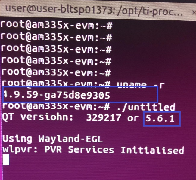

  • HI Margarita,
    I observed that the default QT version is same for SDK03.03 (kernel 4.4.41)     and     SDK04.02 (kernel 4.9.59).
    I got the QT version when I run the app in evaluation kit with default Linux image of SDK04.02.
    Am I doing anything wrong ?
    Please find attached images for both the SDKs.

    I am not very sure what you are running to check qt version but please check the release notes.
    processors.wiki.ti.com/.../Processor_SDK_Linux_Release_Notes
    processors.wiki.ti.com/index.php
    Even in 3.03 the qt version is 5.6.2.
    However under /linux-devkit/sysroots/x86_64-arago-linux/usr/lib I see libQt5Core.so.5.7.1 for example.

  • Hello Margarita,
    I understood why QT_VERSION_STR is 5.6.1
    The reason is we are using the qmake of SDK03.01    for SDK 03.03 and SDK04.02 for cross compiling in QT app (in QT creator) --> http:// processors.wiki.ti.com/index.php/File:Sitara_Linux_QT_options.jpeg
    Note: SDK03.01 qmake is of QT 5.6.1 --> Hence I am getting the error
    I found we are not able to use qmake of SDK 03.03 or SDK04.02.
    t is throwing an error " not able to find gnu/stub-soft.h" if we use SD03.03 or SDK04.02
