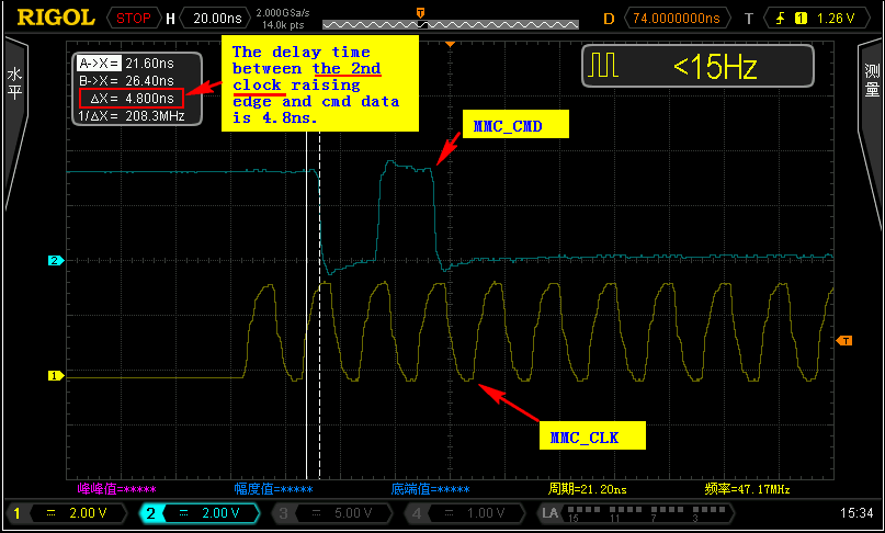

In AM3352 datasheet table 7-90, we see that in opp100 high speed mode, td(CLKL-CMD) and td(CLKL-DAT) is in 3ns - 14ns, customer measure the timming of  td(CLKL-CMD) and td(CLKL-DAT), found the real value of this parameter is different for every cmd or data.
I want to confirm that if the value of  td(CLKL-CMD) and td(CLKL-DAT) is different for every cmd and data and the scope is between 3ns - 14ns?

    I want to know that if THE DELAY TIME is dynamic changed  for every cmd and data transmission, and the scope is between 3ns - 14ns?
  • I mentioned the previous post because there have been a few cases where someone did not get the expected result and we found it was because they were measuring the delay relative to the wrong clock edge based on their configuration of the HSPE bit.
    The delay values provided in Table 7-89 and Table 7-90 define the range of delay for each CMD and DAT output relative to the clock output. This range represents the worst case delay value across process, voltage, and temperature variations. It also includes delay variation introduced by circuit delays and propagation delays which will cause delay variation across the outputs. So you are correct, the delay is different for each output and the data sheet only defines the range of each output relative to respective clock edge.

    Another question, I have set some register bits  to apply the automatic clock gating strategy:
    - SD_HCTL[2] = 1    ==>   High speed(48MHz)
    -  SD_SYSCONFIG[0] = 1, SD_SYSCTL[CEN] = 1, SD_CON[16] = 0   ==>    automatic clock gating strategy
    The measured results are shown as follows. Is the first clock invalid??
  • Clock transitions are used to synchronously transfer data to/from the card via CMD/DAT signals. The clock can run continuously or be stopped between transfers to save power.
    I was only able to find one requirement related to stopping the clock in the SD Card specification. It discusses a requirement to continue the clock for 8 cycles after the end bit or status token. Therefore, I assume driving the clock one cycle before the transfer begins is allowed.
