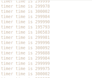

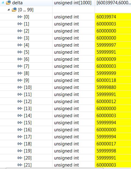

I am developing DSP RTOS program on IDKAM5728.
I configured a timer interruption. Days ago, I found that it don't interrupt strictly per 2ms when I set it as a 2ms interruption.
So I wrote some code to test it (I have changed the period as 10 ms ).

there is some of its output:
some time is strange.
And I have tried to configure intfreq as 20M and not to configure extfreq.
It get the similar outcome or even a worse one.
