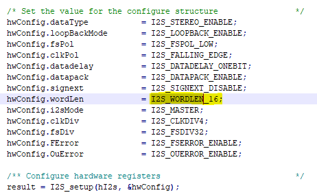

I'm using kit EVM5517, and I want to configure Register I20SCTRL for DSP processor and CODEC with WDLNGTH=16 bit data or 24 bit data.
But in SPRUH16B, page 386, section 7.3.1, bit 5-2, there are only 3 mode 8 bit, 10 bit, 32 bit data. How can I configure mode 16 bit data or mode 24 bit data for DSP to communicate to CODEC?
