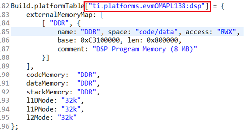

So I have a problem being able to load compiled TI-RTOS DSP Firmware from my Linux.
This DSP firmware is a modified TI-RTOS example, it's the USB Audio Example that is compiled for the OMAP-L138.
I have a added a custom resource table to the project and tried to modify the .bld file and the RTSC configuration file using some settings from the MessageQSingle example but the end results in the Linux kernel locking up completely after loading the firmware and the firmware doesn't actually work when loaded this way.
The Firmware works when loaded through the CCS Debug directly into the C6748 inside the chip through a JTAG Debugger.

In order to get the IPC source table to work, I had to modify the RTSC board settings file for the evmOMAPL138.
I had to modify the DDR to be 0xC100000 since IPC uses 0xC0000000 to 0xC1000000.

  • Hello Dmitriy,
    Just an FYI, you can change the memory configuration directly from the config.bld instead of changing the RTSC platform. All you have to do is append :dsp to your platform in project properties and it will automatically pick up the platform table specified in config.bld.
    The nice thing about the config.bld is that you can make memory configuration changes directly from the application level. Your method works too, I just wanted to let you know about this option.
    Now, to get this example running on the DSP when the ARM is running Linux, you will need to make sure the cores are not trying to use and initialize the same peripherals. You can look at the device tree source (DTS) files to see what is being used by the ARM core. For OMAP-L138, da850.dtsi contains the SoC-level definitions, and da850-lcdk.dts contains the board level definitions (da850 and omapl138 are equivalent devices). These files are located under ti-processor-sdk-linux/board-support/linux/arch/arm/boot/dts.
    For starters, by looking at mcasp_cfg.h on the DSP side, and the DTS files, I can see that both cores are trying to use MCASP0, EDMA0, and I2C0.
    You have a few options:
    1. Let the ARM do all of the peripheral configuration/initialization and remove any initialization calls done on the DSP side.
    2. Let the DSP do the peripheral initialization and in the Linux device tree, disable the peripherals that are being initialized by the DSP.
    For example, to disable UART3 and prevent the kernel from putting it to sleep, you would add the following to the device tree:
