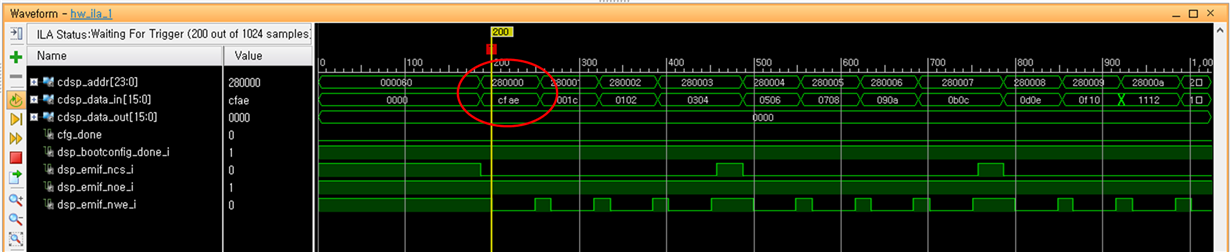

c6678 is connected to DPRAM of FPGA over EMIF16 interface. I am sure that the hardware connection is correct. EMIFA23 is connected to A0 of DPRAM  as mentioned in EMIF16 user guide.
The problem is that when c6678 write odd word length data, the first word is not properly saved to DPRAM.
Please let me know how to resolve this problem.
I captured test code. Just memcpy array to DPRAM.
When writing 16 word, the first word was sent correctly - value is 0xcfae to address 0x78500000.
When writing 17 word, the first word was sent twice(high byte, low byte separately) to same address 0x78500000. Consequently DPRAM has only low byte - 0x00ae.

    I tried 16-bit stores in for loop instead of memcpy().
    Every word transferred correctly to DPRAM.
    The difference from memcpy() was that CS signal was asserted at every time WE signal was asserted.

  • Hello!
    In the starting post of the topic the most notable difference was in behaviour of CS vs WE signals. That's just the sign something was different in access.
    As loop with 16-bit writes was fine, I think the true reason might be in implementation of memcpy() function. I found something I think might be relevant at TI\ccsv8\tools\compiler\c6000_7.4.24\lib\src\memcpy64.asm :
    ;* void *memcpy(void *restrict dst, const void *restrict src, unsigned int len)
    ;*   char *restrict s_p  = (char *)src;
    ;*   char *restrict d_p  = (char *)dst;
    ;*   int   loop          = len >> 3;
    ;*   int   i;
    ;*   if (len & 1)      *d_p++ = *s_p++;
    ;*   if (len & 2)    { *d_p++ = *s_p++; *d_p++ = *s_p++; }
    ;*   if (len & 4)    { _mem4(d_p)  = _mem4(s_p);  d_p += 4; s_p += 4; }
    ;*   if (loop == 1)   _memd8(d_p) = _memd8(s_p);
    ;*   if (loop >= 2)
    ;*       for (i = 0; i < loop; i++, d_p += 8, s_p += 8)
    ;*          _memd8(d_p) = _memd8(s_p);
    ;*   return dst;
    If I got it right, they try to copy 1, then 2, then 4 bytes until remaining count gets multiple of 8 and then proceed with 8 byte copying. So I suspect, when your word count is odd, or, equivalently, your byte count is even, then following line is executed:
    This makes two byte accesses, which you observe as high and low bytes of the first word were sent separately.
    For me, I am surprised memcpy() implementation attempts to adjust counter at the beginning and proceed with unaligned _memd8 instead of search for aligned boundary. But either way, you'd better keep away of using memcpy() to serve your peripheral.
    In your position I would not disregard for loop in favour of memcpy. With alignment that could probably result in very efficient implementation.
